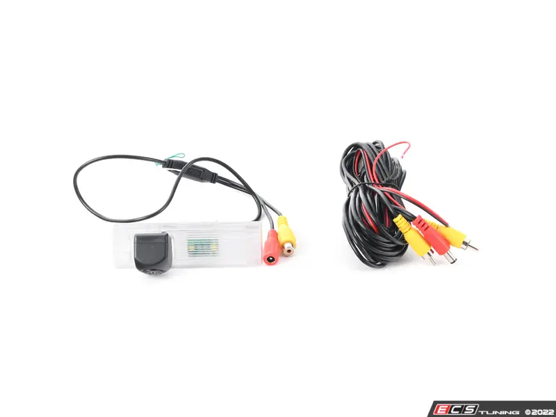

We have the back up cams also that go in the lic plate lights: R60/R61 https://www.ecstuning.com/b-bremmen-.../002480brpc03/
Others: https://www.ecstuning.com/b-bremmen-...or-electrical/
