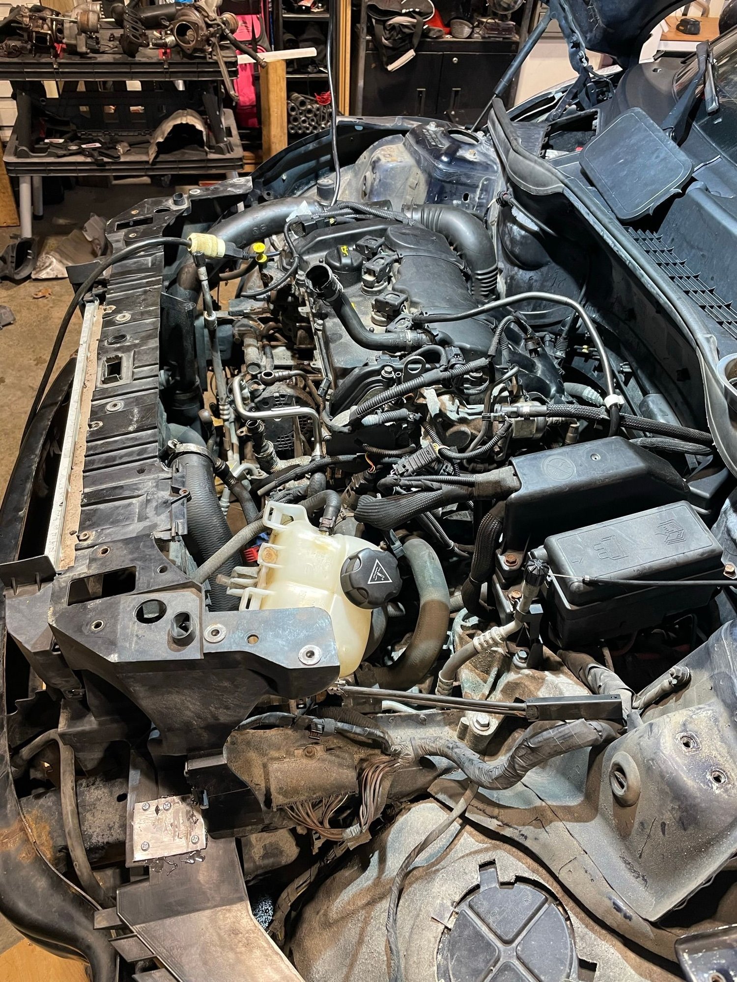

Pardon if my forum etiquette is off in any way. I'm new here and new to Minis. My wife has a 2012 Mini Countryman S that I'm attempting to get into front service mode so that I can replace the alternator. I feel I've removed every bolt mentioned in this thread, but I can't get the front end to budge an inch. I'm stuck and would appreciate a bit of help.
This is where i am..nowhere really haha
I’m in the same predicament. Im trying to address an oil filter housing leak and swap out all the seals and turbo lines while there. I was able to get the oil filter housing out without they bay in service mode, but it may come in handy putting everything back - specially the aux water pump mounting bracket back into the oil filter housing.
I took the number cover off, the two bolts and one Torx from each side of the actual bumper. I have yet to take out the four bolts from the underside that seem to allow the front end forward. I was trying to follow ModMini front end service mode (r56) as a guide, but I’m not seeing anything close to it on the countryman.
I did notice there are two additional bolts that secure the heavy plastic frame to the body panels. Did you remove those?
ModMini guide - I cannot locate those guide holes that are pointed out. Also, I was looking for three bolts and a Torx on each bumper end (only found 2 and the Torx). I did loosen the air ducts forms the wheel cover just in case.
Two bolts and a Torx on drivers side.
From the inside of the car outwards. Seems that if I remove that bolt ( and a couple of other fasteners in the corners) I could take the bumper off, but that still would not help much as it is attached to the underbody that actually slides out. Let me know how you fare out. I would really like to know and get this done.
This is the additional bolt holding the sturdy plastic brackets to the body on each side.

This was the culprit. It never looked like much, but there's a nut on the back of it
... right here... after this were removed on both sides, the front end was free
The job is done! But now I've run into another issue. After getting the car put back together and driving it with no issues for a couple days, today it won't start. After pressing the ignition button, it violently sputters and tries to start, then stops...any ideas?
