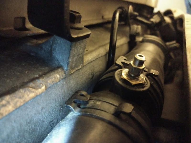

The first time I drained and refilled my coolant I couldn't believe what a lousy design the bleeder screw is because it's unavoidable to get hot coolant splattered all about, and adding to that is I had big trouble trying to purge out all the air so I was flushing out a rather massive amount trying to get rid of the bubbles.
After that experience I tried to find an elegant solution for the lousy stock design and finally settled on using a brake bleeder repair kit which threaded in perfectly and I sealed it up with some high temp sealant. The end result ain't exactly elegant, but it is functional and makes for mess-free purging. I connect a long clear hose to the nipple and put the other end in a bucket to catch the coolant.

Great idea. But one of the biggest shortcomings of the Mini cooling system remains that there is no petcock near the junction of the radiator and lower hose.
