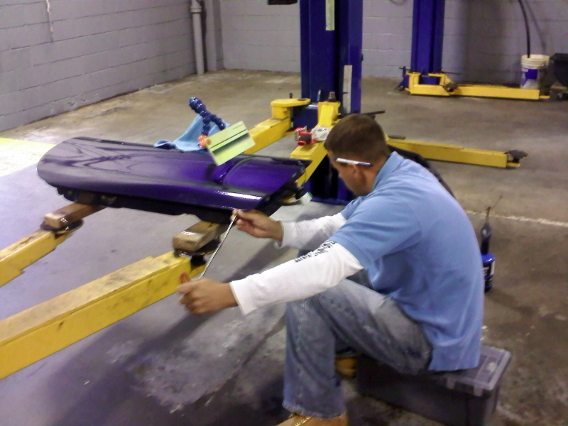

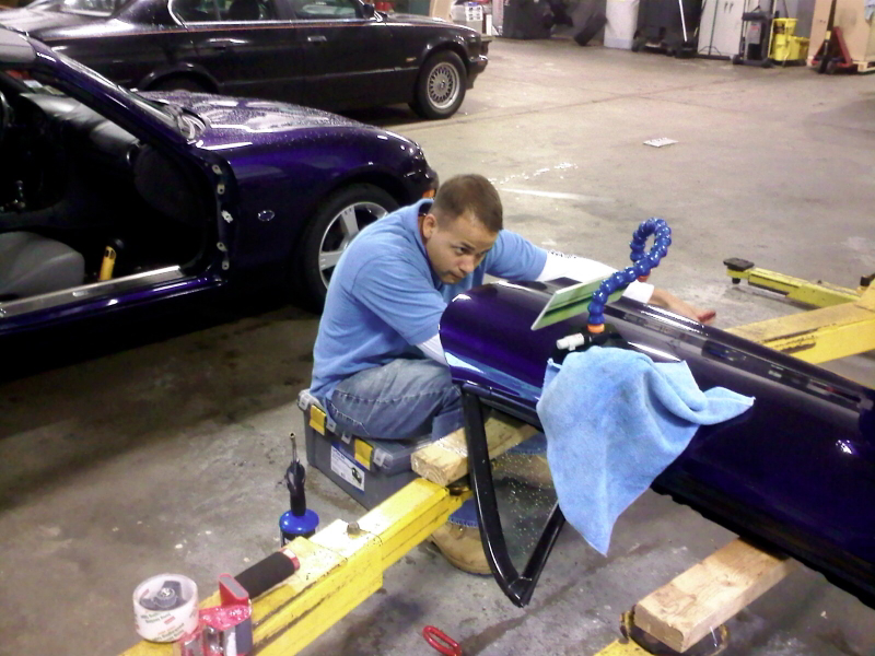

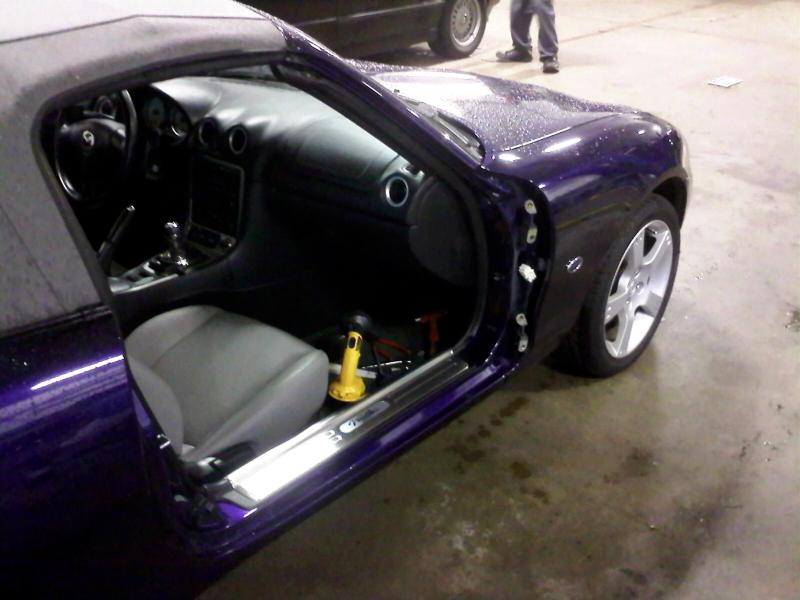

PDR is the way to go. A buck or a buck and a quarter is normal. You won't ever notice it and no painting involved. Worth every penny. Have had dozens taken out in all my cars over the years. Here is my PDR guy working on my MIATA. it was a 6 inch crease. I took the door off for him in 10 minutes. Door dent-image-2325244959.jpg Door dent-image-1889252403.jpg Door dent-image-1838539831.jpg That's how it's done Sent from my iPad using NAMotoring
