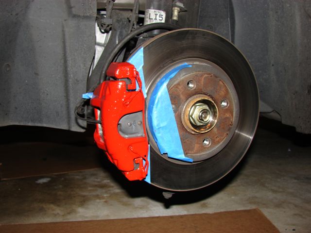

i just did this 2 days ago. i am very pleased with the outcome. it took right around 4 hours (from jacking up the car to the last coat) when done, let them dry for 24 hours before putting the wheels back on and driving. i also rotated mine and added some air to all 4 tires. if you do that, don't forget to reset your flat tire monitor, if you have run flats. i posted some pics! enjoy
Attached Thumbnails Easy painted calipers?-mini-garage.jpg   Easy painted calipers?-mini-front-caliper.jpg   Easy painted calipers?-mini-rear-caliper.jpg
