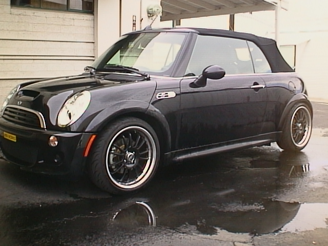

Old Mar 20, 2006 | 11:08 AM
Mini Works's Avatar
Mini Works
Joined: Feb 2006
Posts: 753
From: Scottsdale, Arizona
I am running 215/40/17 with a Koni Sport Suspension, there is no rubbing
