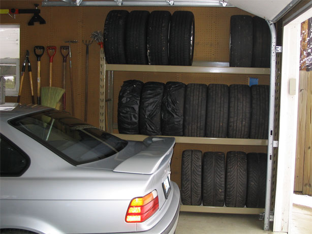

I assembled a 3-tier rack from Gorilla brand heavy-duty steel racks which I bought at Menards, a Midwest regional home store. Tires stand upright, side by side. My BMW sized tires fit 7 to each tier, narrower Mini fits 8. Because the crossbeams come in a variety of lengths up to 96" you can put together the size and capacity you need. No casters available as far as I know, but since my full rack weighs well over 1,000 lb I have no desire to wheel it around.
Total cost was around $175.
Neil
