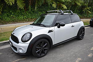

I have a '13 base cooper (yeah I wish it was an S too) Its come time for me to replace the current tires as Ive owned it for 1 year now. currently it has 205/45/17 on the conical mini 17x7 wheels. It is slightly lowered (not sure what the previous owner did to it as he didn't know much about the car). I have been debating between replacing the tires with another set of 205/45/17s but if there is any performance benefit to 215/45/17s or if that will cause rubbing? I have read the 215/45/17s are slightly taller than the stock 205/45/17s. I have attached a couple photos to show the fender gap right now.
For the tire I was looking at the Conti Extreme Contact Sports they seem to have excellent reviews for their price point. I am open to suggestions!

I think my car has those Contis - but runflats. I'm shocked I don't hate them. They do okay Will replace them with firehawk 500s or Pilot super sports.
I bet you'd notice zero difference in pure performance over such a small difference - would focus on the tire make up and capabilities more than its width.

Michelin Pilot Super Sport 215x45-17. Awesome tire wet and dry, no rubbing and I'm lowered more than you.

any 215/45-17 is going to fit no problem, the MINI speedometers are set to read a bit high so the slight diameter increase of a 215 vs. 205 is not going to be a problem, and will probably bring indicated speed a bit closer to real speed.
Don't know where you are in CA, but unless you're in the Sierras or far northern CA you can drive a Max or Extreme performance summer tire year round. The type of tire is going to make more of a difference than the size, switching from an all season 500 treadwear rated tire to a max performance summer tire with a 300 treadwear rating will be a huge difference. After that going to a 215 will be a small incremental improvement in cornering.
