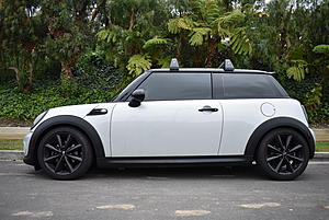

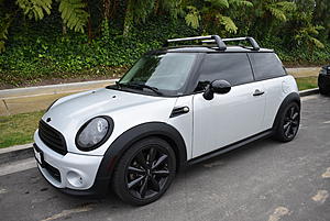

Hello all, I have a '13 base cooper (yeah I wish it was an S too) Its come time for me to replace the current tires as Ive owned it for 1 year now. currently it has 205/45/17 on the conical mini 17x7 wheels. It is slightly lowered (not sure what the previous owner did to it as he didn't know much about the car). I have been debating between replacing the tires with another set of 205/45/17s but if there is any performance benefit to 215/45/17s or if that will cause rubbing? I have read the 215/45/17s are slightly taller than the stock 205/45/17s. I have attached a couple photos to show the fender gap right now.

I chose 215/45/17 because the new Michelin Pilot Sport 4S iss available in that size,
but not in 205/45/17. The Pilot Super Sport, which is almost as good a tire, is
available in 205/45/17. I have had no problems with rubbing or clearance on a 2009
JCW Cooper Clubman with +45 offset wheels.
215/45/17 should fit well, many others have done it also, but the performance difference has
more to do with the model tire you're using than with the small difference in size.

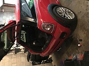

Here is a pic of my car when I was putting my rear bumper back on. You can kinda see how the tires look. (IDK why it's rotated, sorry about that.)
