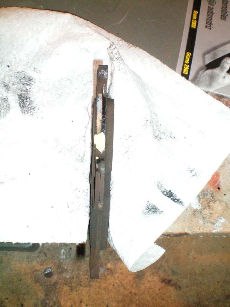

knowing what a worn disk brake pad looks like can save you MANY dollars . . .
you can check your pad condition without even removing a wheel
ask nice and I'll tell you how ... or search my posts for a pictorial . . .
teaser
