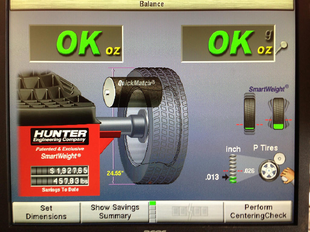

Tuesday comes, I visit autoeurope to get my wheels checked and if needed to rebalance, they run the test, and they tell me there's one wheel which seems to be slightly bent. they used hunter roadforce balance and the rim readout was 0.026 which compared to the maximum allowable number is 0.1, they think it's acceptable. So they rebalance all 4 again, and they put that wheel in the back which was in the front to reduce the wobble. I leave autoeurope to go home, and guess what? the wobble is still there. I call tirerack and told them about that wheel/tire. tirerack ask me to go back to autoeurope and ask them for the rim readout print so i can sent it to tirerack and have them deal with the wheel/tire. I call autoeurope again to ask them if they have the rim readout, the adviser who i dealt with earlier tells me their hunter roadforce balancer doesnt print readouts, then they put me on hold for a minute and then they tell me to come back and redo that wheel to get the rim readout because they have it. I go there, and the advisor apologizes stating that he didnt know if their machine did that. So they take that "slightly bent wheel" out again and rerun the test and they print me the rim readout. I arrive home, sent the copy of the rim readout plus the receipt for the rebalance to the person i was dealing with at tirerack and gave the person a call, but didn't hear anything back. another person from tirerack calls me back after couple hours to tell me that they want me to go to another tire shop who can get rim readouts and verify that if that wheel is bent or not. I call the tire shop they asked me to go and they tell me they are closing early today, so i scheduled an appointment for wednesday "today". in the meantime, i decided to stop by discounttire which is a tire shop in my area to verify that autoeurope weren't just playing games and wanted to get rid of me and my problem. I asked discounttire to have the wheels and tires checked on their hunter roadforce balancer and to tell me the readouts for every wheel/tire and whether any of them need rebalance or if any of the wheels were bent or any of the tires were bad. After 30 minutes of waiting, they pull my MINI in the shop and run the tests on all four. the rim readouts numbers came out good: 0.004(the suppose to be slightly bent wheel), 0.013, 0.006, 0.004. they guy who ran the wheels on the balancer seemed to be pretty knowledgeable to me and he was an assistant manager there who done the test, and by coincident, he also had a mini cooper

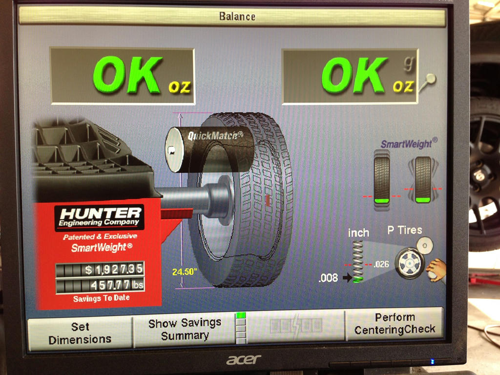

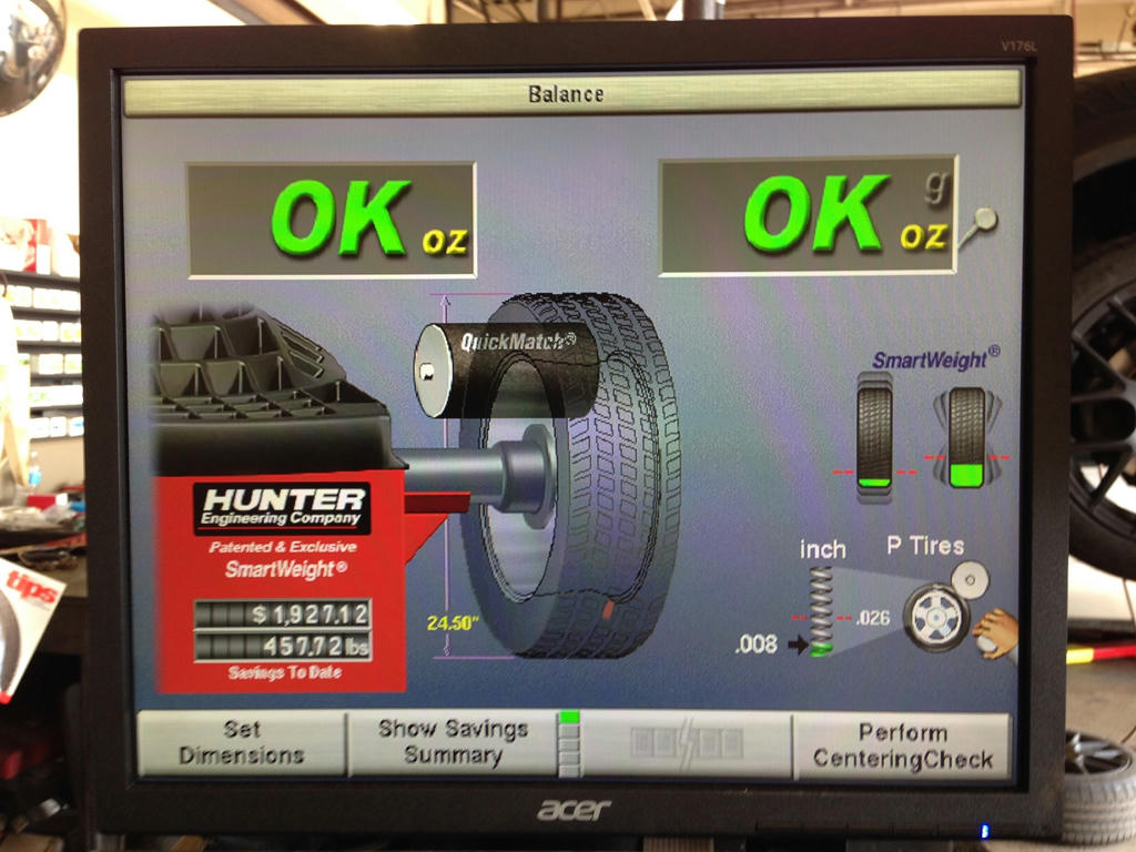

. He was nice to let me come in there and watch him run the tests on each wheel while the shop guys were busy running around. I took a picture of every rim readout, and he comforted me that the wheels and the tires were excellent no problem. He told me might be another problem I have and is definitely not the wheels or tires and he recommended me to give detroit tuned a visit. the guy at discounttire finished the paperwork and it was free of charge which was very nice of them. I left discounttire and called detroit tuned and explained the situation, and they told me to bring it in to look at it. they took the mini for a test drive, they saw the wobble i was talking about, and they told me it could be the wheels are not balanced. they ran the wheels on their balancer and 3 of the wheels were very out of balance and was recommended to rebalance them(that left a big confusion in my head

i doubt its the tires. the tires are michelin pilot super sport 215/45/zr17 mounted on 17x7.5 sparco pro corsa wheels. Here are the numbers for the last wheel readout.
