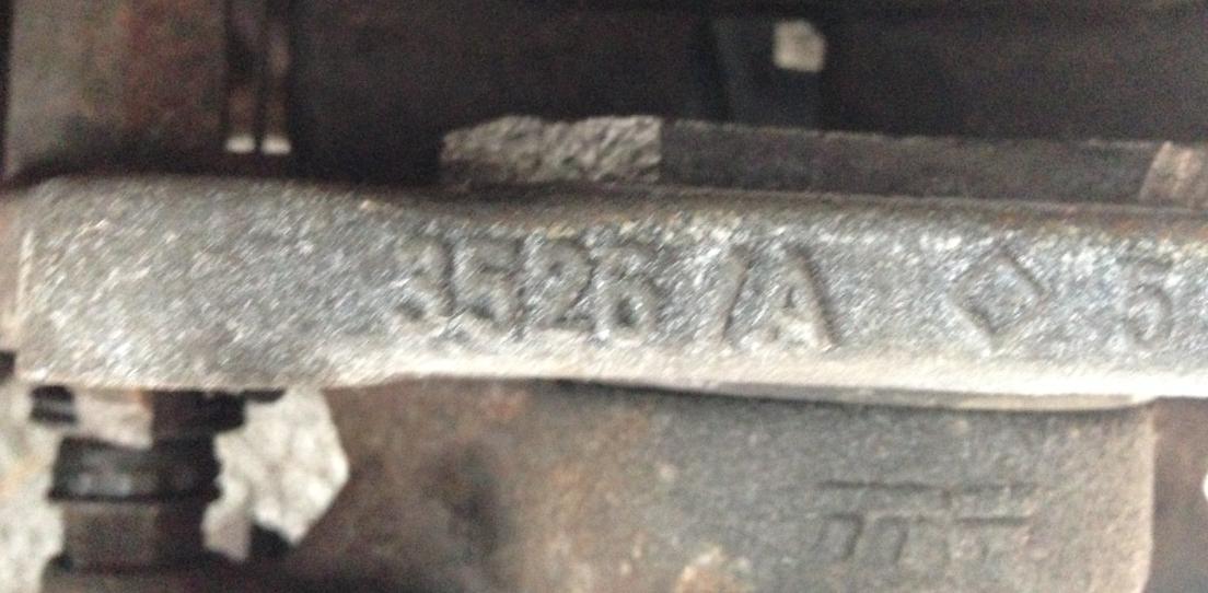

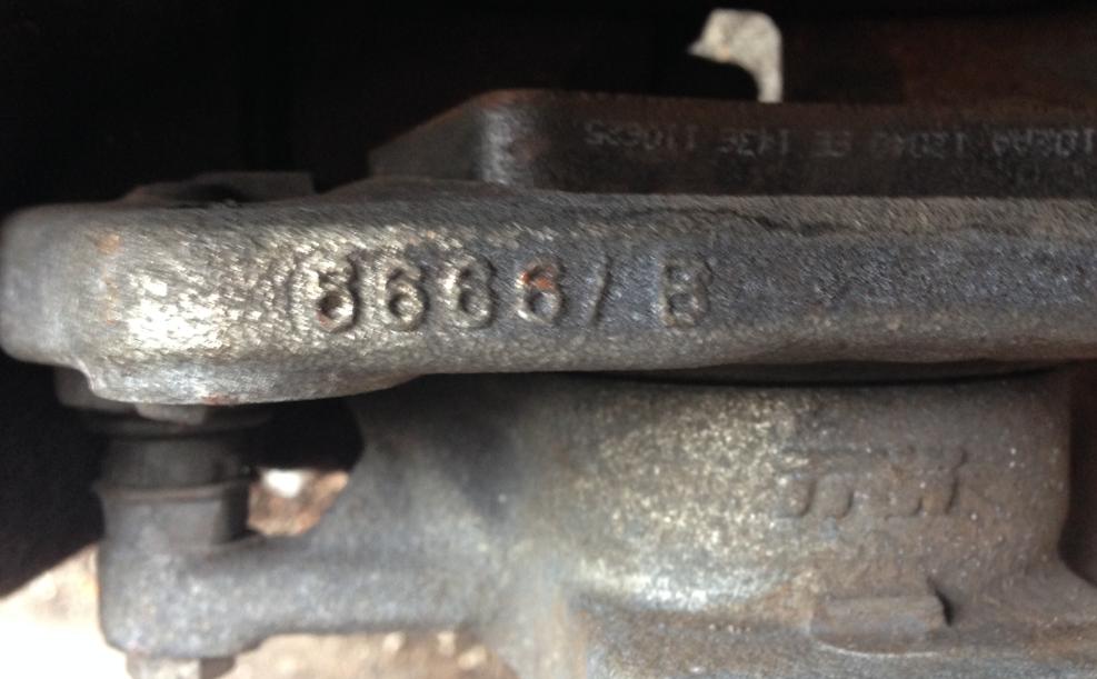

Here is a status update:
Just to do split the project into phases, I've started by ordering only the driver side caliper - I've got one from a 2007 S-model for about $45. I was lucky and that one has arrived with the brake hose - lucky because hoses are different, you cannot reuse the R50 hose on the 294mm caliper. I've ordered cheap centric 12534101 rotors and 10212040 pads just to make sure everything would bolt together.
Now the sad part: couple of weeks ago I've finally ordered the passenger side caliper - I believe it was from a 2011 S, maybe clubman. While the caliper looks the same as my now 294m driver side, the pad did not fit into it and the rotor did not fit inside the caliper when it is mounted on the spindle. Apparently I've got the 280mm brake setup with my 2nd order :(
Looks like the 280mm and 294mm calipers are the same but maybe the caliper bracket is different? Not sure, maybe someone knows exact part numbers for calipers and for brackets? update: looks like "BRAKE CARRIER" is the proper part name, smth like 34119804734. Need to go check the number on mine
In the meantime I have not much choice but to order another passenger side caliper and hope for the best.

I had to take the brakes off, clean them, take pictures, guess what these rusty numbers are, google - all that to find the perfect article on this subject: http://www.c0op3r.com/MINI/FrontBrakes.html
Oh man, I wish I had it when I was starting the swap.
The bracket we need for a 294mm swap has 6666 cast:
The wrong bracket which I am not sure how I got since the seller was claiming it was S is 3526:
Finally I know exactly what I need to buy to finish this project
