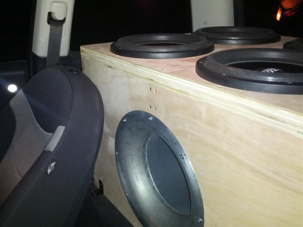

If I had to guess how much weight I have added into the rear it would be roughly 350-400 pounds. About going over bumps and stuff, I always go slow over them. Not trying to go over a bump fast, and randomly have any part of that equipment come loose and fly around the car haha. Just snapped 2 shots of my rear tire, it was with a cellphone and it is dark outside so I apologize for the images.
EDIT: Here is the only picture of the entire car I have on-hand right now if it helps. If more pictures are needed I can snap a few tomorrow.

Man you are throwing a lot of information at me, I really appreciate it. I do check the rear of the car, not on a schedule or anything. But I look over the entire car from time to time to check up on everything. So far the weight in it is good as it sits right now.
I did a little more searching today while I had some free time and I found some wheels that are the stock size that I like a lot. The only problem is I think they are an older model that may be discontinued or something? But they are the XXR 518's (http://www.xxrwheels.com/xxr_518.shtml) I'm not sure what it is about them, but I really like them! And I assume since they are the stock size, just a different offset (+40), this would be a good choice with not having any actual problems of rubbing? I tried looking up places to buy them from, but since I have never bought wheels online (or at all for that matter...) I'm not sure if the websites are legit or not.
I found them on: customwheelsdirect, sonicmotor, and wheelplususa.
If anybody has information on those websites consisting if they are a legitimate company to give my money to, it would be greatly appreciated.
To tremperj, the setup consist of..
Sub Stage:
(4) Sundown Audio SA-12's
(1) AQ2200D
Highs Stage:
(4) Cadence 5.25's (2 behind your head on each side of the car)
(8) Cadence Tweeters (Mounted with the 5.25's behind your head, 4 each side)
(1) RF300.4 (Only running 2 channels currently. Waiting to get 2 more sets for the front doors)
Electrical:
Stock Alt (Have a 200a from Singer Alt waiting to be installed)
(1) Kinetik 1400 (in place of the stock battery)
(1) Kinetik 2400 (as my extra)
All Wiring is KnuKonceptz OFC. Tons of 1/0 & 4Gauge
