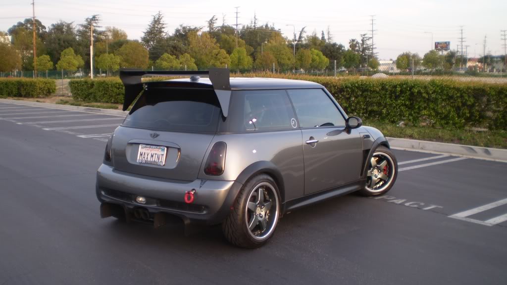

These are 17 / 8 et 42 Hamman with 215/45/17 BFG's . I am about 1.75 lower than stock you should have no issues
Randy
