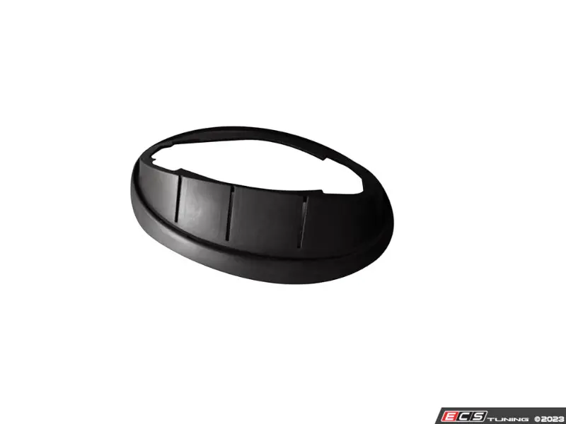

I had the same issue due to the extreme temperatures, but I just fixed it. I got the peice here: https://www.ecstuning.com/Search/SiteSearch/Mirror_Gasket/ES83238/
It says they're OEM, and that they fit for all models. Unfortunately, I did have to force the rubber to fit. I have the R56 model. Despite that, it looks like brand new and I'm happy with the results. It took me about an hour to do both gaskets.

ES#83238 and ES#83237, is for the R50 R52 R53 models, there is a bug we are working on with the fits section on some parts. Please use the drop down menu for your model to get the correct parts. There is no separated part number for the R56- R59 mirror gasket. Its part of the whole mirror assembly. But looks like you found a part from the Gen 1 to fit gen 2 , congrats on the OEM mod. First time I have heard this works, do you have pics ?
https://www.ecstuning.com/Mini-2007-Cooper-R56-Base-Coupe-L4_1.6L_N12B16A/Exterior/Mirrors/4
Update***
We added some aftermarket options for the R55-R61 MINIs, direct fit and direct copy of the gasket on those models.
Left
https://www.ecstuning.com/b-bremmen-...167261775~brp/
Right
https://www.ecstuning.com/b-bremmen-...167261776~brp/

Thanks for the reply, ECS tuning! I definitely should have used that search tool; however, it does say that it fits all models on the site.
Even though it's not the right part, I still managed to make it fit! It's not perfect, but it does the job and it looks pretty good. Here's the results:
If you look closely, you can see where the old rubber was. I have to clean it a little more, but I just did it last night and I couldn't see what I was doing anymore, lol!

I just went through this. I purchased the Gen1 gasket set through ECS Tuning, they can be made to work but they require some modification with a razor blade and don't fit that well. Google to the rescue - search for "Mini R56 side mirror gasket" and a bunch of aftermarket options come up, including through Out Motoring and Amazon.
