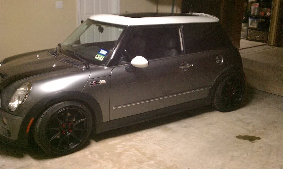

Just put some xxr 527's on my car! 17x8.25 +25

I need to work some magic in the back though. I've rubbed through the plastic and now I think I'm actually hitting metal :l
ps, sorry for the cell phone picture, I'm working on getting some better ones!

Is the car lowered any? If so how much and on what setup?

I'm on megan coilovers with hsport control arms. In the picture, the front and back are both down all the way. This afternoon, I raised the back end about 1/4 of an inch to get rid of my rubbing problems.

Love the red nuts with the black wheels

watch it, he likes your "red" nuts! LMAO
Glad you got it cleared for no more rubbing.

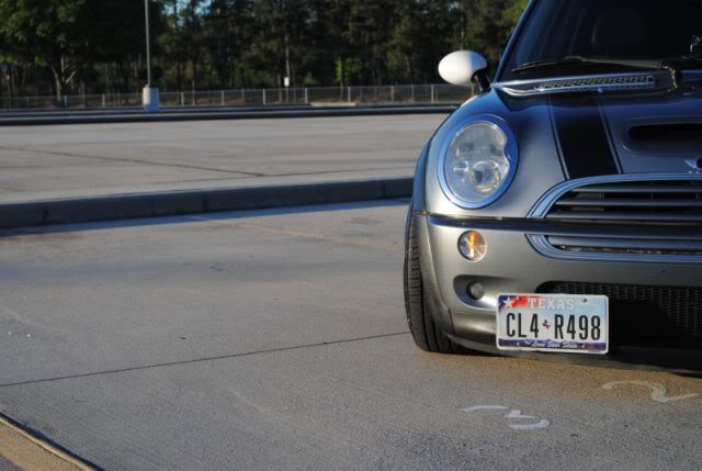

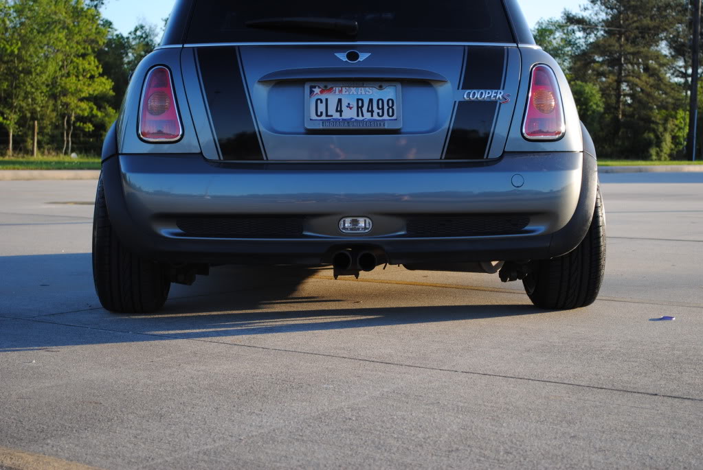

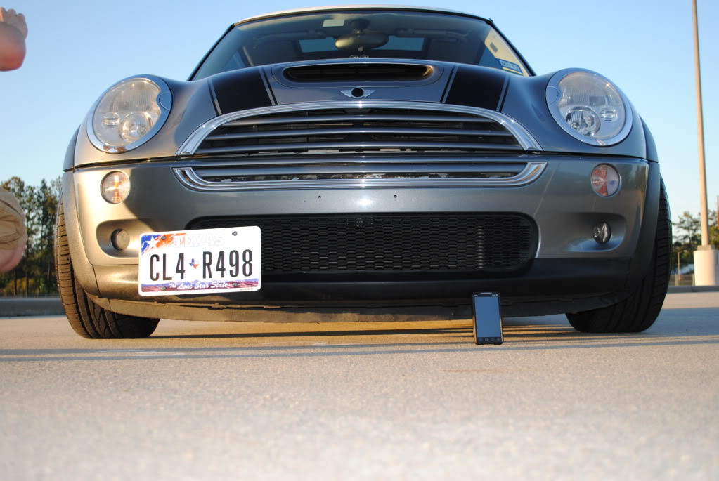

You got any pics of the car from the front to rear that show if they are tucked or poking? What size tire are you running on the rims?

Here are a couple more, the tires are 205/40/17

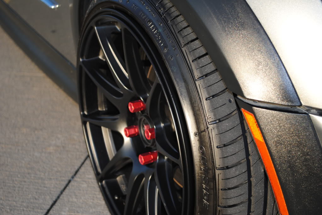

thanks srtoad! it's just a cheap ebay conversion with sickspeed tuner lugs

Goldenomer, thanks for the pics. I am looking at getting the same wheel in chromium black for my white silver clubman. I just needed to see if the top of the wheel was tucked or poked. Thanks for showing me my answer. Also did you have to do anything with the camber or toe?

Can you post a link to the stud conversion? There are tons of different kinds online.
Thanks again man, cars looking awesome with those 527's.

@rum, i run about -2 degrees of camber, but i'm also lowered so if you're at stock height, you should be fine
@srtoad, here is the link http://www.ebay.com/itm/20-PCS-BMW-5...12d55d&vxp=mtr
i got those and the lug nuts are just generic 12x1.5 tuner lugs
