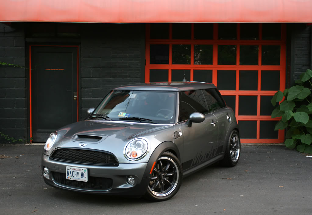

I've run some bigger tires...
This is Rota MC, 18x8 +45, with 225/35R18. (I would have run 235/35R18, but they were too expensive!)

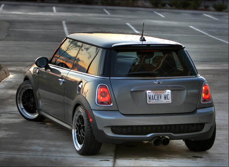

This one is Rota RB, 17x7.5 +45 with 235/40R17.
The 235 is really tight. The factory struts have good clearance, but aftermarket coilovers are not as good, and would need spacers to move the wheel/tire away. Then you'd start to run into the plastic fender arches...
