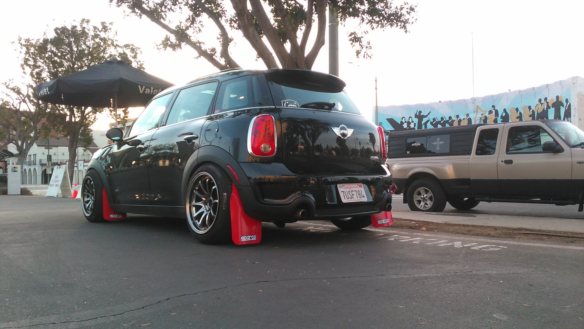

This is my r60 I know they are wider then 8.5 I'll get back to the sizing

^^^siiiick. Great stance

On my car the rims are 17x10 wrapped on 205/55/17 super stretched tires and lowered to the point only one finger fits ,looks good but you need to do a good amount of trimming on the inside

How did you trim your fenders?
I'm running 17X8 +35 with 225/45 Federal RSRR (runs wider than most). I don't hit fenders while doing track days or autocross. But on severe bumps (or light ones with passengers in rear) I'll hit them rather sharply.

I had the exact same problem, sounds like your inside splash guard might be the one doing the rubbing not your fenders, i trimmed mine a good amount but it still rubbed on something, i took my rim off and noticed my splash guard was rubbed. take something sharp and cut it off should solve the problem.

Your situation sounds dangerous. Check inner fender felt-like material and trim accordingly. Check plastic fender trim for signs of wear. Both of these can be fixed with a sharp instrument. Check the steel under the felt and you can go old school roll out with a baseball bat. Finally, check your CAMBER and make necessary adjustments.

Keep in mind I am on coil overs and fender rolling isn't an option on a countryman with plastic fender flares

Those 10" wide are aggressive, nice they fit.
