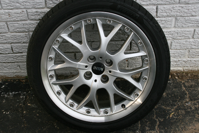

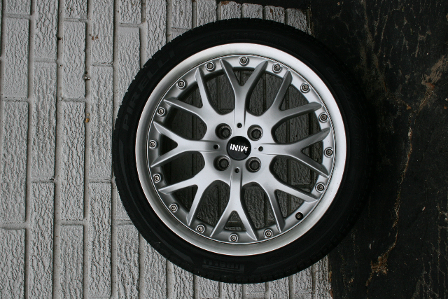

Can anyone verify that these are real and not replicas based on the pics? Thanks!

One way to check is to see if the wheels are actually multipiece, there should be some fairly obvious indication on the rims if they are.
It's my understanding that the replicas are 1-piece, and the bolts around the perimeter are fake.
Nice looking wheels, I'm hoping to get a set of R90's on my MCS to complement the Aero Kit.

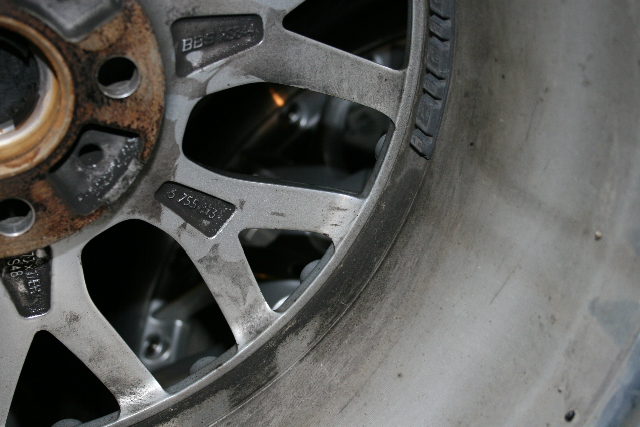

look at the back of the wheels...should have 'BBS' cast in with other stampings like 'MINI' '7x17EJ47' or something

Looks real...
Won an Ebay auction yesterday for this set and the seller did send me more pics. So I'm paying a total of $1041 ($900 + $141 shipping). They have about 9000 miles on them and come with Pirelli Eufori@ runflat tires. So how did I do on price? Do I still need to balance and align them at a shop or can I just install them myself? I'm not much of a DIYer so any other advice?

looks like you got the real deals. i cant comment on the price, i dont know what theyre going for...
i personally wouldnt get them balanced unless they felt strange after putting them on the car. no need for alignment if your car drives straight and true.

if you check the rivets.. it should say like BBS VS on it...
very small.. but it's there...
