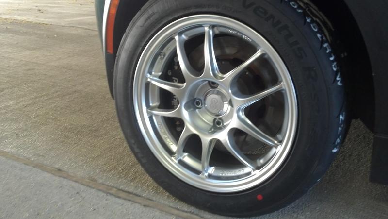

I recently installed 5Zigen GN 20 17 x 7.5 +42 wheels without spacers over my Wilwood FSL calipers.
