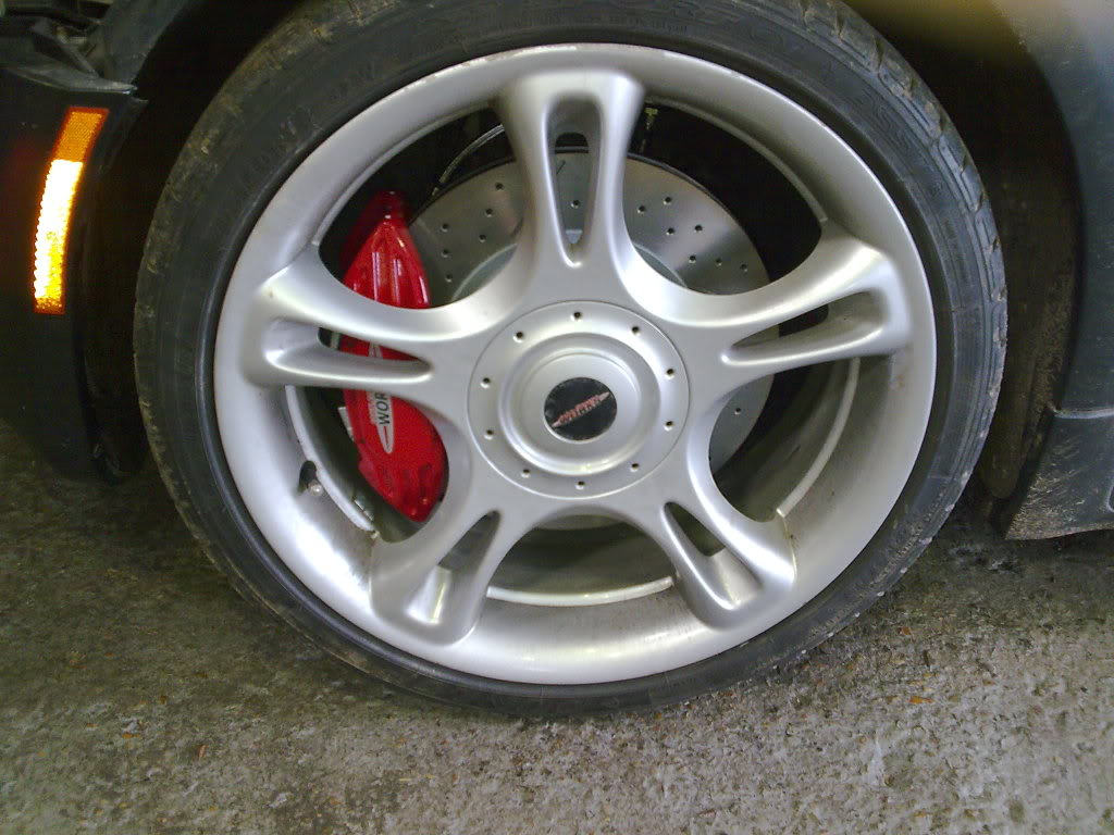

Keano's Avatar
Keano
Joined: Oct 2008
Posts: 159
From: Ipswich, UK
Originally Posted by Keano
Anyone tried an R95 spider spoke with the R56 JCW Brembo kit ?
Need to know the size of spacers needed.... please
Did some test fitting and a 7mm spacer is need with the R95s Im running 12mm but a 7mm would be enough...
