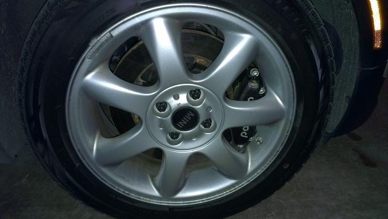

I'm looking at Todd's P1 Track Kit with the 12.19 rotors in front and the Wilwood Parking Brake Kit for the rear. I have two sets of OEM wheels (R121 Conical Spokes and R110 Pace Star), both of which seem a little too shallow for the calipers to clear. 5mm doens't seem like lot of difference, but I guess they only need to clear by a bit to work huh?
Even with careful measurements it feels like a leap of faith to just order and hope all will fit. I've got a buddy who owns a tire / brake shop who will do the install, so I've at least got some pro help there.

That is a great kit. Had that on my '07 S. A lot of stopping power.
Do I assume correctly that you intend to track your MINI? Then the added 5 mm of a set of spacers would be helpful for tire wear. The 48 mm offset that the stock MINI wheels have results in a fair amount of rollover of the front tires in corners. Less offset, which the spacers will provide, helps to improve that. Yes, they only need to clear a little bit. 5 mm is just over 3/16", you could that amount of cardboard and set it on the wheel hub and measure the clearance again. Also, if I remember right, the template that Wilwood gives is a little conservative as it doesn't have the rounded corners of the actual caliper, although that too is a leap of faith.

I have the Wilwood 12.19 rotor and Pace Star wheel on my Clubman right now with the 5mm spacer and they clear fine. They are required since interference occurs at side of the spokes nearest the rim, there is plenty of space in the diameter. Rather interesting that my Enkei RS+M 16inch wheels clear with no spacers.

It's my daily driver, but Northwest MINI hooks customers up with a few track days each summer, so I'd like to get out there and drive it without cooking the stock brakes. Originally Posted by Eddie07S
That is a great kit. Had that on my '07 S. A lot of stopping power.Do I assume correctly that you intend to track your MINI? Then the added 5 mm of a set of spacers would be helpful for tire wear. The 48 mm offset that the stock MINI wheels have results in a fair amount of rollover of the front tires in corners. Less offset, which the spacers will provide, helps to improve that. Yes, they only need to clear a little bit. 5 mm is just over 3/16", you could that amount of cardboard and set it on the wheel hub and measure the clearance again. Also, if I remember right, the template that Wilwood gives is a little conservative as it doesn't have the rounded corners of the actual caliper, although that too is a leap of faith.
Good luck with it.
It sounds like 5mm should be enough extra for the R121's and definitely for the R110's.
Thanks for all the help!
I've got a beautiful set of black conical spokes that replaced my Pace Spokes when I bought my Clubman and I'd love to find a way to run the Wilwood BBK with them. Second choice would be to have my Pace Spokes painted black and run those. Originally Posted by MaxGSeeker
Duaflex,I have the Wilwood 12.19 rotor and Pace Star wheel on my Clubman right now with the 5mm spacer and they clear fine. They are required since interference occurs at side of the spokes nearest the rim, there is plenty of space in the diameter. Rather interesting that my Enkei RS+M 16inch wheels clear with no spacers.
Thanks for the info. I appreciate knowing the Pace Spokes will work with 5mm spacers.
Cheers.

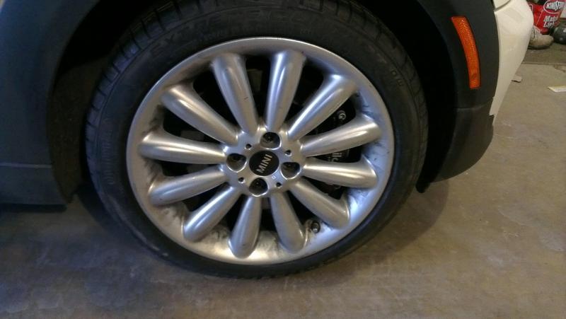

The 12.19" Wilwood kit fits under my 16" Bridgespokes without any spacers. I've had them on all winter. Please excuse the dirt and salt.

Looks great!Originally Posted by mattkosem
The 12.19" Wilwood kit fits under my 16" Bridgespokes without any spacers. I've had them on all winter. Please excuse the dirt and salt.--Matt
Is this the race or street kit which retains the dust boots?

This is a real good representation of how the spoke clearance has such and effect on the brake kit. This is a 16" wheel and fits, yet larger 17" wheels don't; not because of the diameter but the wheel design.Originally Posted by mattkosem

Thanks Originally Posted by NJ Mini
Looks great!Is this the race or street kit which retains the dust boots?
I'm hoping my infinite streams will fit next week when I get new tires mounted on them. They fit the JCW brakes, so I'm hoping it'll fit these too.It's the street kit.

Nice look. Those brakes fit well in those wheels. Also, that is a great track setup; especially useful for the amount of power your car has and top end it will produce.
Is there a list available that would show what 16" wheels would work with Wilwood 12" And 1" drop?
There's a list of wheels that will fit in the OP, and others that aren't accounted for throughout this thread (even one on this page). The drop won't make any difference.
