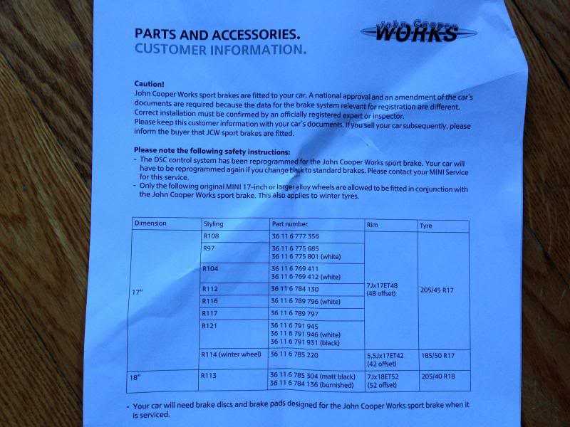

here is the list of wheels that Mini has approved for the JCW 17" Sport Brake kit, these seams to vary by year which is why there is such vague info out there, in my case I was ready to buy new wheels but it turns out the R121 Conical spoke wheels are compatible making my life sooooo much easier

DSC Reprogramming required with a BBK?????
H
I find the text in the Consumer Information very interesting. It says that the DSC is reprogrammed with the addition of the JCW sport brakes. I wonder if this is done for the DTC as well and has anyone done this when they have installed a BBK? I am mostly interested in this for the eLSD that stays on after the traction control is disabled.
I definitely feel as though the eLSD is more effective with the JCW BBK that I have installed presently than it was with the Wilwood setup that I was running last year. It was noticeably less effective with the Wilwood setup vs stock, and has a more stock-like demeanor now.
--Matt

Did you have the DSC reprogrammed with the install of the JCW brakes?
Yep, got the full procedure.
I'm fairly convinced that the difference in behavior can't be attributed entirely to the more stock-like demeanor (initial bite, etc.) of the stock JCW pads, since the Front EBC Yellow/Rear EBC Read on all stock caliper setup that I had prior to replacing the fronts with the Wilwood kit still had reasonably stock-like eLSD behavior.
--Matt
--Matt
Matt,
If I had to guess, I would say that you at least drive aggressively. Have you ever track either of setups? Your experience if you have...?
I talked to my SA about doing this on my car with the Wilwoods. He said that he would need to check. I'll post what he comes up with.
Matt,
Well, to be expect, my SA says that because the DSC upgrade was designed for the JCW brakes and may be incompatable with the Wilwoods, they can't/won't do the up grade.
FWIW - everything except the eLSD seems to work fine with the Wilwood. The ABS, traction control and stability control all seem to work as well as they should - "tested" them on the track. The eLSD doesn't seem to get enough "bit" with these brakes. It is almost like an open differential.
Matt,
I'd say so yes. This car hasn't been on any tracks quite yet, and won't until the warranty is up. I'm a bit nervous about the front caliper pistons under high temps, but I'll cross that bridge when (and if) I come to it.
Is the adaptation for the rotors something that you can do yourself (ie. an adjustment rather than a flash)? I noticed the pretty much the same behavior you're mentioning with the Wilwoods as well. The eLSD wasn't working very well at all. The ABS definitely works properly, but I'd say the TCS doesn't intervene quite so gracefully as it does now. With it on, rather than running into situations where it would gently cut down on spin like it does now, I seemed to much more frequently end up having it intervene very aggressively (and noticeably).
