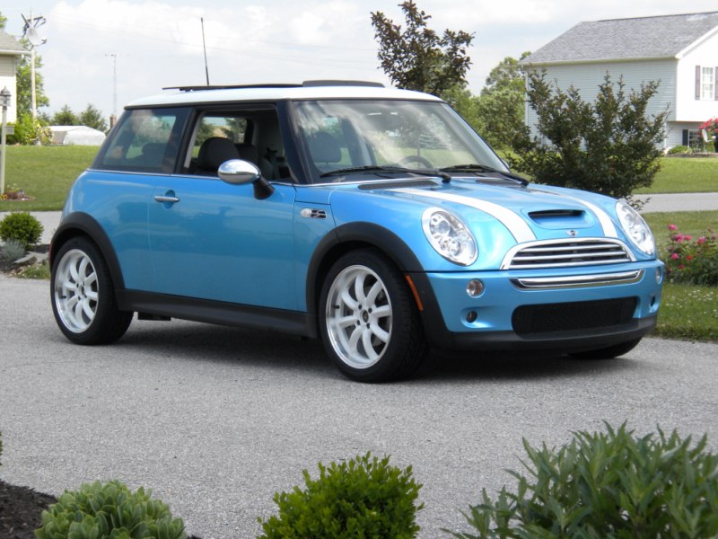

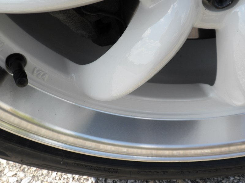

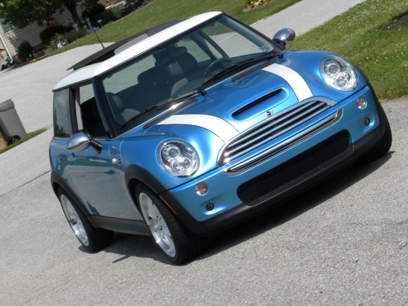

What are my options if I want a different center cap?? The one that come with the RB's look good if they are black or dark silver. But on white they stick out like a sore thumb. Not to mention one of mine chipped when I put it on
Anyway of getting something to sit flush?
Oh.... here are mine..
I sent the design to Aesthetic Creations with the specs. for the exact dia. and several months later, they sent me these:

So you just replaced the/covered the rota emblem?? I want to do away with the plastic centercap altogether. I already emailed Aesthetic Creations, I measured the hole and its 2 11/16 inches
Like this: http://www.prestigewheel.com/cgi-bin...n&key=99-95095

Yes. Covered the Rota logo. What A.C. provides is a domed plastic logo with adhesive back. It does not replace the centercap.
