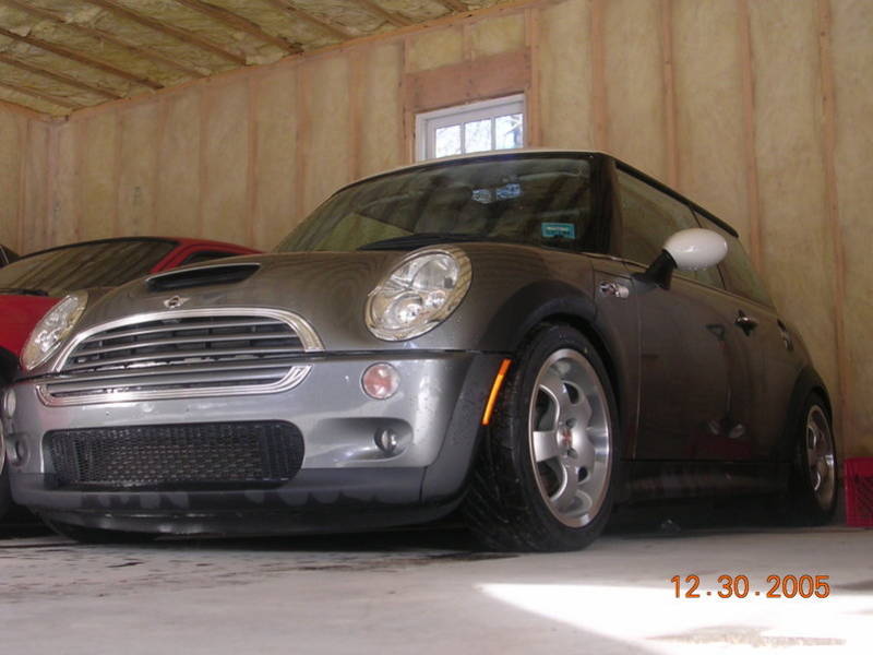

15x8 6UL rims and 225/45-15 tires
1.7" drop Bilstein PSS9 coilovers

In terms of look, it can easily be pulled off if you get the right drop and tire size
My old rims 15x7 et35 tires are 205/50/15
