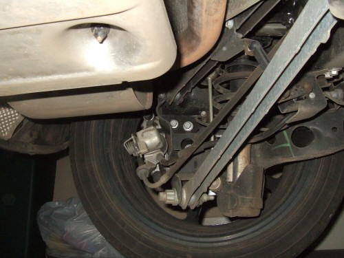

Are we talking traling arms, or control arms? A photo would be nice so we can make sure that we are talking about the same thing...

The trailing arm is #4. What exactly is different between the R53 and R56 rear suspension besides the trailing arms being aluminum? There was a change sometime in 06 to the lower control arms. Early on they were black and sometime they turned to silver. I'm not sure if there is actually any difference besides the color. But the latter setup, minus the aluminum trailing arm looks like the same suspension as the late 06.

The trailing arm and the upper and lower arms are different. Click on pic for more views. Thanks to GPMINI for pics of his GP.
