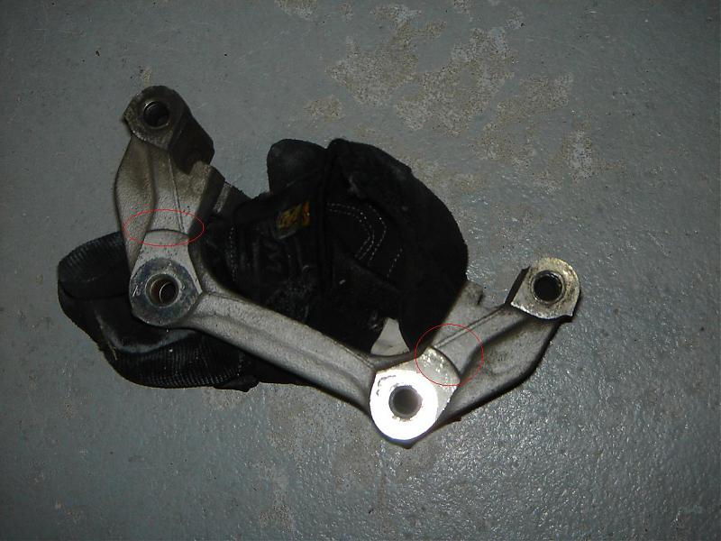

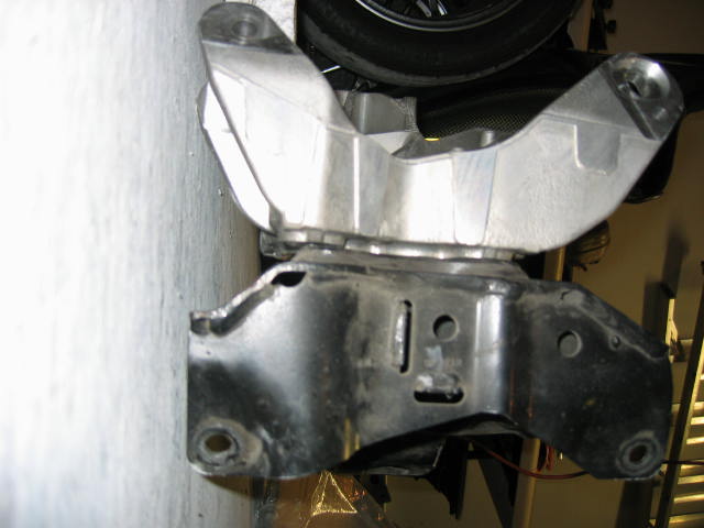

update
Visuals of what we believe will require modifications:
Lower shock bushing. This comes part of the R56 shock. I guess for all of you hoping an R53 shock would fit (on an R56) , you'll probably need this piece machined first. May be we should make a few extra sets ...
For the caliper bracket, It barely needs a brush to continue the machined surface - and one side only - just can't remember which one any more. Barely. We'll see soon...
Attached Thumbnails 07 aluminum trailing arms retro-fit?-r56shock1-mod.jpg   07 aluminum trailing arms retro-fit?-r56shock2-mod.jpg   07 aluminum trailing arms retro-fit?-carrier-mod.jpg

Bushings/inserts machined...
Sorry. Poor quality picture.

We decided just to file the extra material needed to clear the carrier. Easy job... another poor picture.
