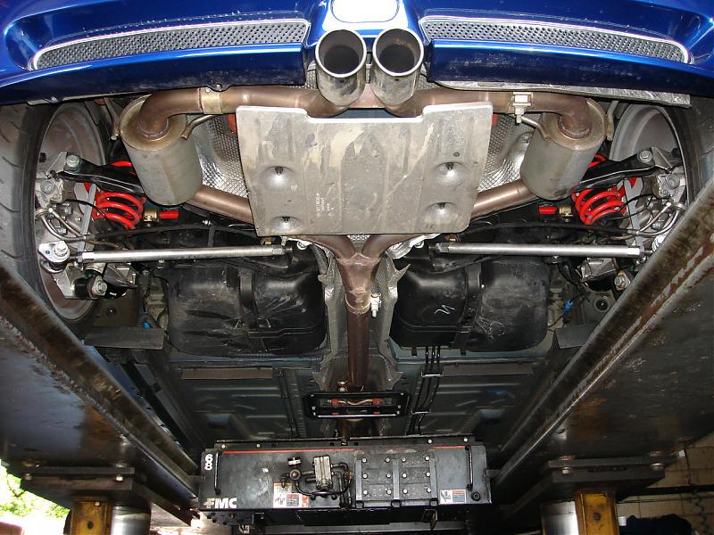

Impressions
Aligned, balanced & road tested 135 miles home.
1st impressions: WOW, really precise and crisp.
Definitely worth the $
Solid as a rock at terminal velocity
Can't elaborate further on that here...
I'll be re-torquing all conections tomorrow after a well earned nights sleep.
Edit: Sorry guys, don't know why pix got nuked. Have to use thumbnail
Attached Thumbnails 07 aluminum trailing arms retro-fit?-suspension-013.jpg   07 aluminum trailing arms retro-fit?-suspension-021.jpg   07 aluminum trailing arms retro-fit?-suspension-011.jpg

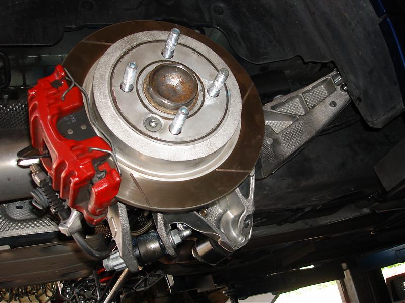

Light Machining of R56 Trailing Arms
No rocket science to it. I'd call this a bolt on w/light mods.
Bottem line is it is do-able, reletively affordable and very trick.
With parts, labor and shop time it came in well under $1K
Attached Thumbnails 07 aluminum trailing arms retro-fit?-suspension-006.jpg   07 aluminum trailing arms retro-fit?-suspension-007.jpg   07 aluminum trailing arms retro-fit?-suspension-008.jpg

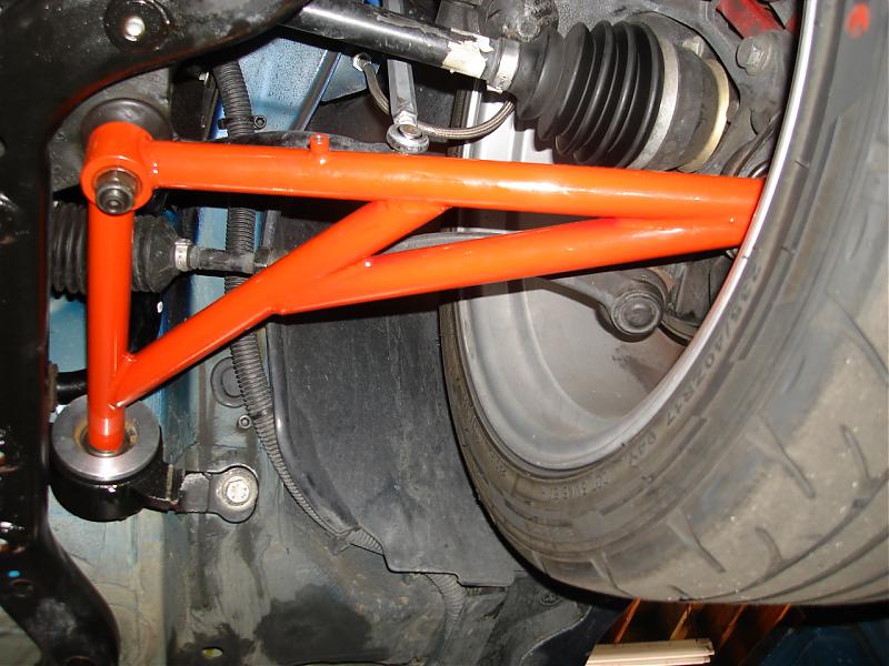

Madness Front A-Arms
These babies are sweet as molassas and really do put the "slot" in slot car!
While we were at it, for *****$ & grins I also threw on a set of Madness Polyurethane engine bushings.
Attached Thumbnails 07 aluminum trailing arms retro-fit?-suspension-010.jpg   07 aluminum trailing arms retro-fit?-suspension-002.jpg   07 aluminum trailing arms retro-fit?-suspension-003.jpg

R56 Trailing Arm retro-fit Review
Post #140 highlights the "light machining and resurfacing" necessary to mate the arms to an R53.
To the best of my knowledge it does not matter what year your R53 is.
You will be replacing everything from the mounting points.
None of your exsisting hardware is compatable with the R56 arms.
You will need all mounting hardware, fasteners and brackets.
Once you have all the hardware in hand and the machining done it's a basic R&R task + alignment.
Feel free to PM me with questions about the install or recomendations on where to buy and where to install.
