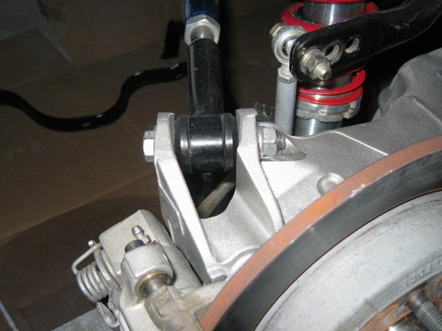

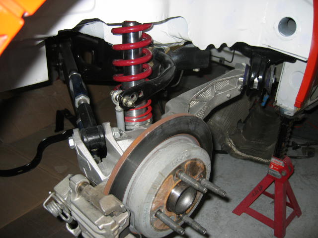

Partial install and everything is fine so far.
One point to notice: the wheel speed sensor are of a much larger diameter on the R56...
We still have to install the shocks. Further update to come later.

So, with regard to the larger speed sensor (on the R56), are there any complications because of this?
I'm chomping at the bit to place an order for a pair of these arms, but want to make sure all is good, and the swap is not highly difficult for one person...
If you get the shocks on tomorrow, how soon before you get some track time? After the alignment though...
--> we'll spend more time on this tomorrow. Not sure yet if the length is the same. If yes, a machined insert may work. Otherwise, you'll need R56 sensors :($$$)

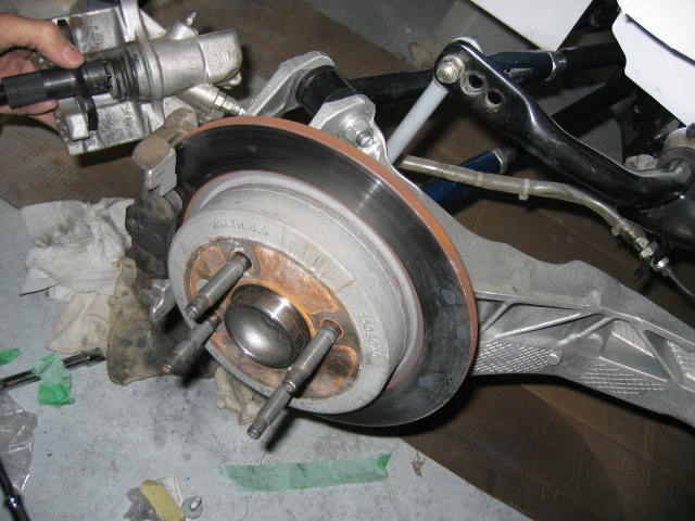

OK, where were we?
Wheel speed sensor: different length and diameter. The GP uses the same one as any R50/52/53 so I guess we just found out one of the main difference between a GP and an R56 trailing arm, apart from the price....
We could probably machine an insert that could fille the void, but we're starting to run out of time. So we'll order a set of R56. Hope they use the same type of signal.... Anyone with an R56 that feels like opening the connector to check the number of wires?
