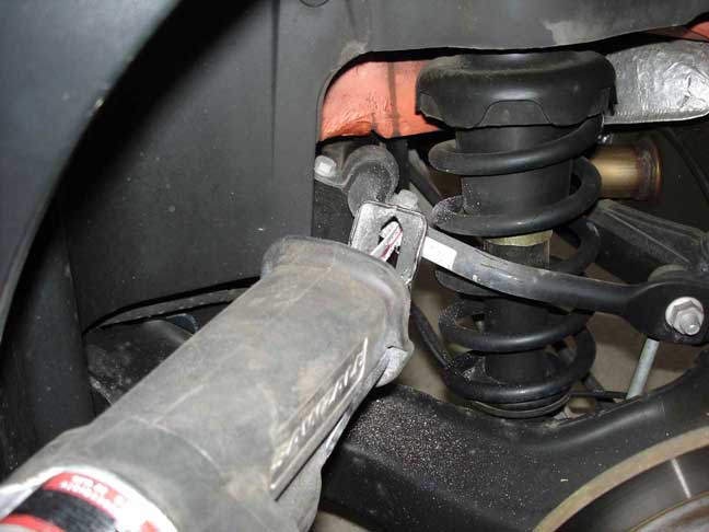

If you are using a saws-all, you may not need to remove any of the the struts. I removed one of the struts to free up room so i could fit the pipe cutter in there, but saws-alls are small, so you may bot need to.
Sway Bar Removed, Struts in Place
Well, I don't have my WMS sway bar yet, but yesterday I managed to remove the stock sway bar on my JCW MCSC without removing the struts. Didn't have to drop the sub-frame. I took pics, hope these help others. The whole removal process was about 30 minutes. The pics show the angle of the sawsall. This is the drivers side. Let me know if these pics make sense.
Not too sure of the reason for cutting the stock bar, besides maybe saving a few minutes... I have removed my stock bar twice, and other ones, in less than an hour. Plus, they serve as a nice upgrade for the Cooper drivers, and with that go for up to 50 bucks. Just something to think about before firing-up the reciprocating saw...

It is nice, because you don't have to worry about alignment, and it saves quite a bit of time, probably 20 minutes or so minimum. We only charge an hour for the install on the WMS bar, whereas we charge two for the other bars.
Thanks for the pics!
Randy
Randy
