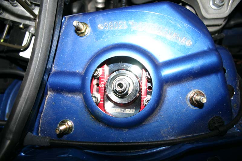

How do you guys adjust camber once the plate is installed in the car? As you can see, it is impossible to loosen bolts once installed. Do I have it installed wrong? Does anyone have any installed pics?

You need to purchase a 'ball end allen key' - I have zero problems reaching all four with this tool.
Also, if you move the two allen screws closest to the car's center line to the middle location, adjusting is that much easier - you'll also get much more negative camber.

Here's another option......
Yeah, I know, surgery makes it a bit more than a pure "bolt on" type mod, but I'm happy.
Before anyone jumps in to tell me I've weakened an already too weak element of the car, we added (welded) some material below so it should actually be stronger now rather than weaker.

Do you know how much negative camber you have in your car with the setting where the picture is? It looks like you're right at the center point of the adjustment scale.
meb, can you give me an idea of how many notches you are (on average, I know both sides are different) from the center to get to the settings you listed in the other thread? I'd like to have a good starting point for when I get the car aligned.

It hadn't been set it yet at that point.

is it possible to just pilot 4 holes?
is it possible to still adjust the camber plate if 4 holes are piloted over the 4 screws, so that they can be accessed by the allen-wrench? if so, would any reinforcements need to be made to retain structural integrity? is a strut brace recommended in this application?

Not necessary. Just purchase a ball end allen key and you're all set.
waldvogelmj, after you move the two allen screws (that are closer to the car's center line) to the two center and currently unused holes - go three to four more notches and give it a drive. Camber can be a triack little beast by the way...like all geometry it has a relationship to something. In this case, as in most, the degree and rate of roll. I simply picked a number that I know will work for my mostly street driving. If I were racing I would be very very technical...and then perhaps still not correct.
When you play games with settings, play with one only. Everything ellse should remain constant, including tire pressure - which does affect camber in a small way.
