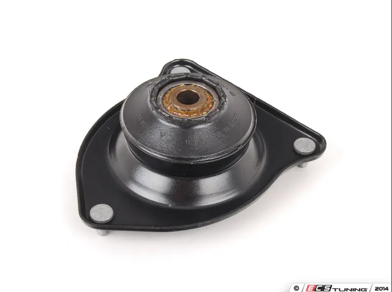

Originally Posted by OutlandishnessDue
The OEM ones are sealed and these are open, but great tip on the coating. I assumed that, since they weren't painted, they must be stainless.
You sure about the sealed bearings?
https://www.ecstuning.com/b-genuine-...o/31352318480/
Those look quite open to me...

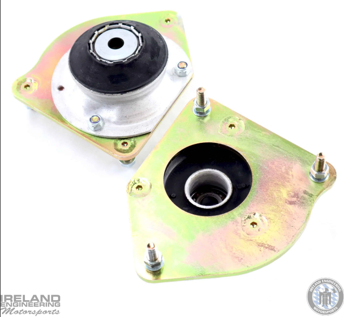

Here are the IE version:

My OEM ones look like these:
My IE plates are these (and a different color metal, hence why I assumed stainless...perhaps they changed the design?). In your photo that looks like an exposed bearing with a washer on top.
If the parts are interchangable, perhaps I can just replace these bearings with the sealed ones should I have problems later down the road.

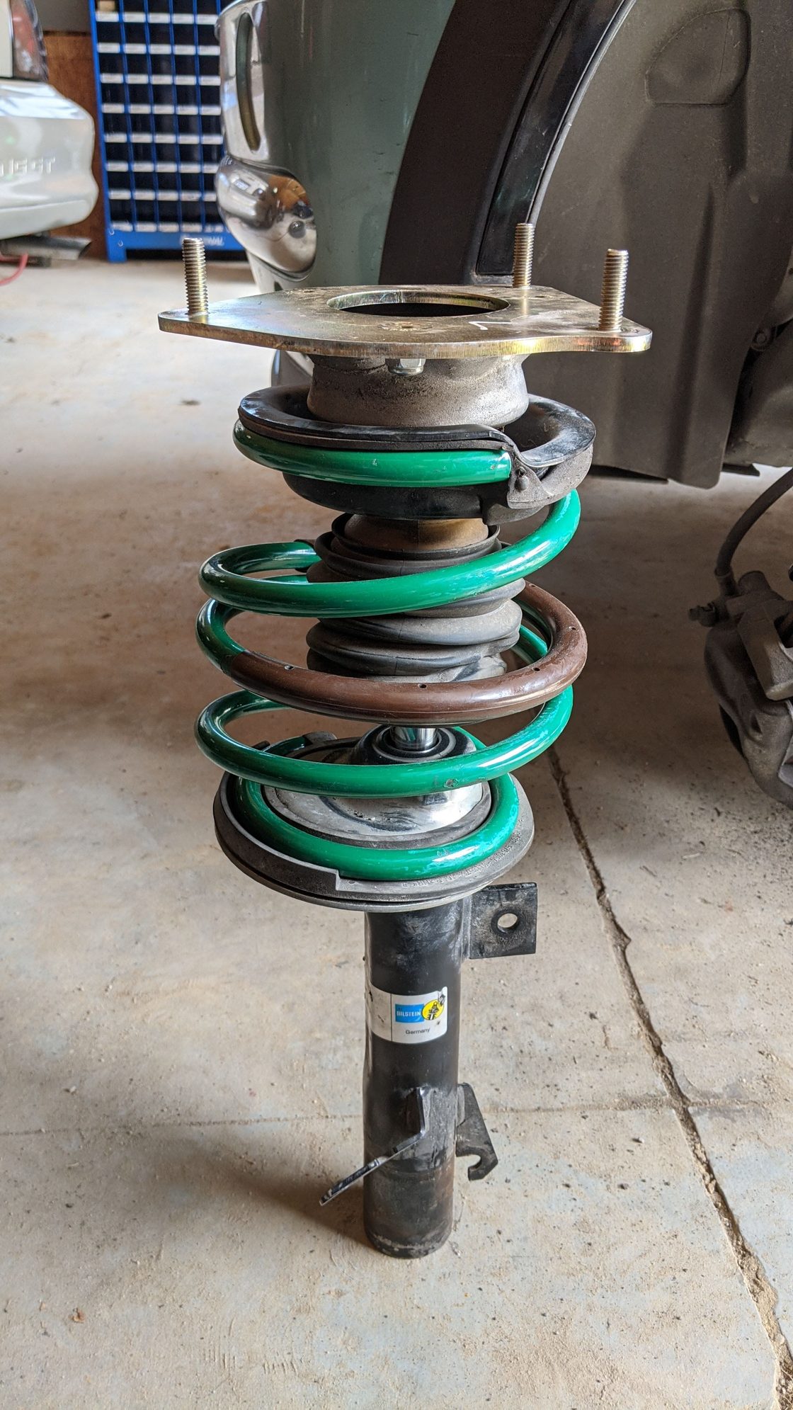

For anyone interested I ran IE fixed plates on a 2003 R50 from August 2020 to February of 2024. Hard street use, regular mountain runs, 4 seasons (out of Northern NC but traveled all up and down the east coast). 40k+ miles per year, close to 150,000 miles total on them with zero issues and no corrosion. They have a heavy gold zinc plating that held up very well. Rubber never tore and bearings were still smooth as silk when I sold the car this February. They were mounted on Bilstein B4s with Tein springs. They also took pothole hits bad enough to bend a Konig Helium rim on one occasion and bent the actual strut on another. The IE plate was bent slightly on the second hit but I simply bent it back in a shop press with no issue to functionality. IMO they are a GREAT product!
