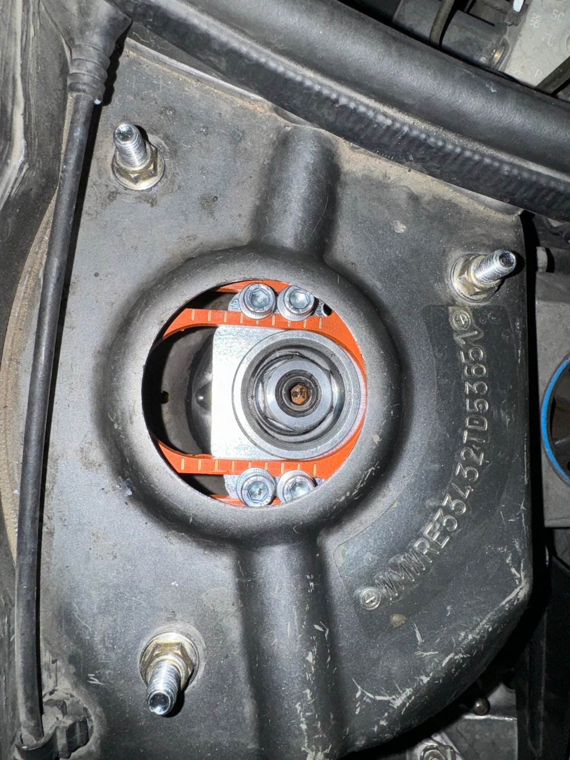

I had the same issue, ordered these from orrange and so far like em
Need to get used to driving with these for sure
I had the same problem, ordered these and so far like them, silver project plates

what's your long term review of the silver project plates?
