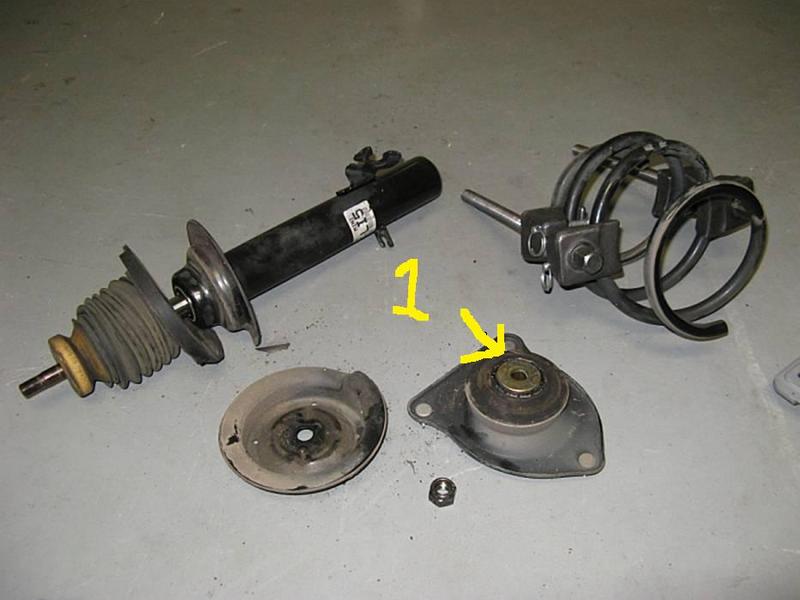

Finally decided that I couldnt stand the crazy increase in wheel gap my adjustable camber plates gave me in the front so I decided to go back to new oem strut mounts. Alignment shop said theyd have no problem getting it aligned up front since drop is only 30mm.
might be paranoid but here is my problem...my adjustable camber plates came and were installed with 3 washers to use between the spring pocket (top hat) and the adjustable camber plates. Normally there is only one washer between oem top hat and oem strut mount but I must have lost that oem washer cause I cant seem to find it anywhere.Now I am trying to go back to stock. I tried using only one of the washers that came with the adjustable camber plates and got resistance from the strut mounts hitting the top hat. I put all 3 of the camber plate washers between the oem top hat and oem strut mount and it there is no resistance and everything seems ok...my question is was it ok to replace the one larger oem washer with the 3 smaler washers that came with the adjustable camber plates?? Everything went together ok..the only difference is there are 3 smaller washers between top hat and mount versus one big oem one..any input would be helpful

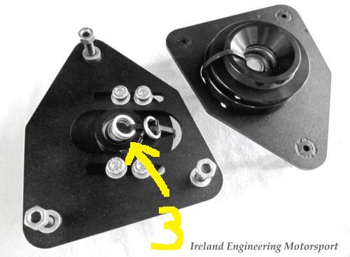

here are some pics....first pic is oem set up with one large gold washer in between mount and top hat.
second pic is IE camber plates with 3 washers instructions said to put between plate and top hat.
I lost the large oem gold washer and used the washres the camber plates came with. I took all 3 to get proper movement and clearance and to avoid oem mount from hitting top hat and just want to know if that is ok...mount spins ok with no friction and everyting went together ok..only difference is 3 small washers rather than 1 large one..just wanna make sure

just an update...so I have now completed replacing my camber plates and putting oem strut mounts on both sides. I had to use the 3 small washers the camber plate kit came with (rather than the large oem washer) in order for the strut mount to clear the top hat. I did both sides equally and made sure both mounts move freely. My ride height went back down in the front. I have Apex lowering springs and with IE camber plates the front wheel gap was 2 1/4" in the front from top of tire to wheel well. Now with stock mounts the gap is down to less than 1 1/4" inch . I origianlly put on the camber plates due to shops inability to align one side. Little did I realize it was because of a failed LCAB and worn ball joints...not the lowering springs. So now I have new tie rod ends, powerflex bushings on everything I could find lol, rear adjustable control arms, and all new ball joints. Alignment should be a peice of cake.
