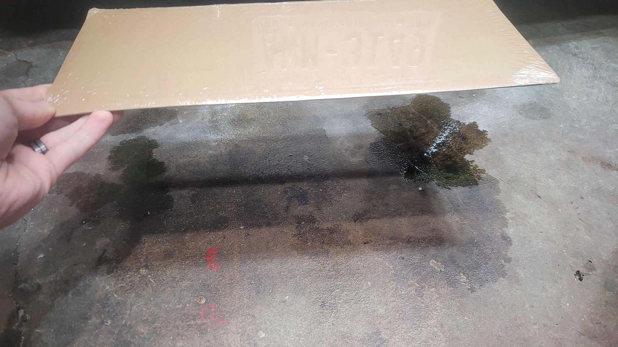

Odd oil leak spots , is it from sensor seals ????
I'm still getting to know this n14 more so please bear with me..
up until last week my car had NOOOOO oil leaks what so ever. Suddenly, it's leaking from I believe 2x possibly 3x spots.. it has nea valve cover and oilpan seal atleast.
1x is the rear left of the engine. I thiiiiiiink theres a cam? Or crank? sensor back there that could have a leaking seal ?? Its definitely not the crankshaft pulley seal.
2x leak spot is on drivers side ,like rite from the middle , once again I see a FEW sensors there with seals but i do see one going into the head and I believe that that is the cause.
would a bad seal in those spots be enough to leave little puddles of sassyness from just sitting over night ?
what are some other trouble areas ir where should I look.
I HAAAAAAAATE leaking ANY fluids so I need to get this taken care of yesterday, lol.
again, any help or tips is much much appreciated.
the pic I took , the cardboard im holding represents where my oilpan would be when parked..

My guess would be to look at that oil cooler housing there's 2x sets of gaskets........

I will 2x check that though the leak doesnt appear to be from that area..

Front Crankshaft Seal. Check around the pulley. Could it be brake fluid?

Add this to your oil, and used a UV light to locate the source of your leaks.
Amazon Amazon
I had two leaks on my N12 engine after a recent rebuild; one was at the eccentric shaft motor gasket, and the other was at the vacuum pump. I replaced the eccentric shaft motor gasket and made sure the flange on the motor was flat, but I still had a leak at the vacuum pump after I replaced the o-ring. Turns out, there is another o-ring under the vacuum pump cover that I could not find a source for that O-ring, so I replaced the vacuum pump, and that solved my oil leak problem.

I did the uv dye and found my leak.. my new pan seal is still leaking a little BUT I have a pretty bad oil leak BEHIND MY HPFP ! and of course they don't sell that Oring/gasket alone so looks like I'm in the market for a new hpfp now. Dang it !

To re-seal your HPFP, you "could" just pull the pump and get a replacement oring from the hardware store... Be warned that aftermarket HPFPs tend to be hit or miss for quality and performance. Going cheap on those doesn't always result in good stable fuel pressure. I hope it works out for you.
