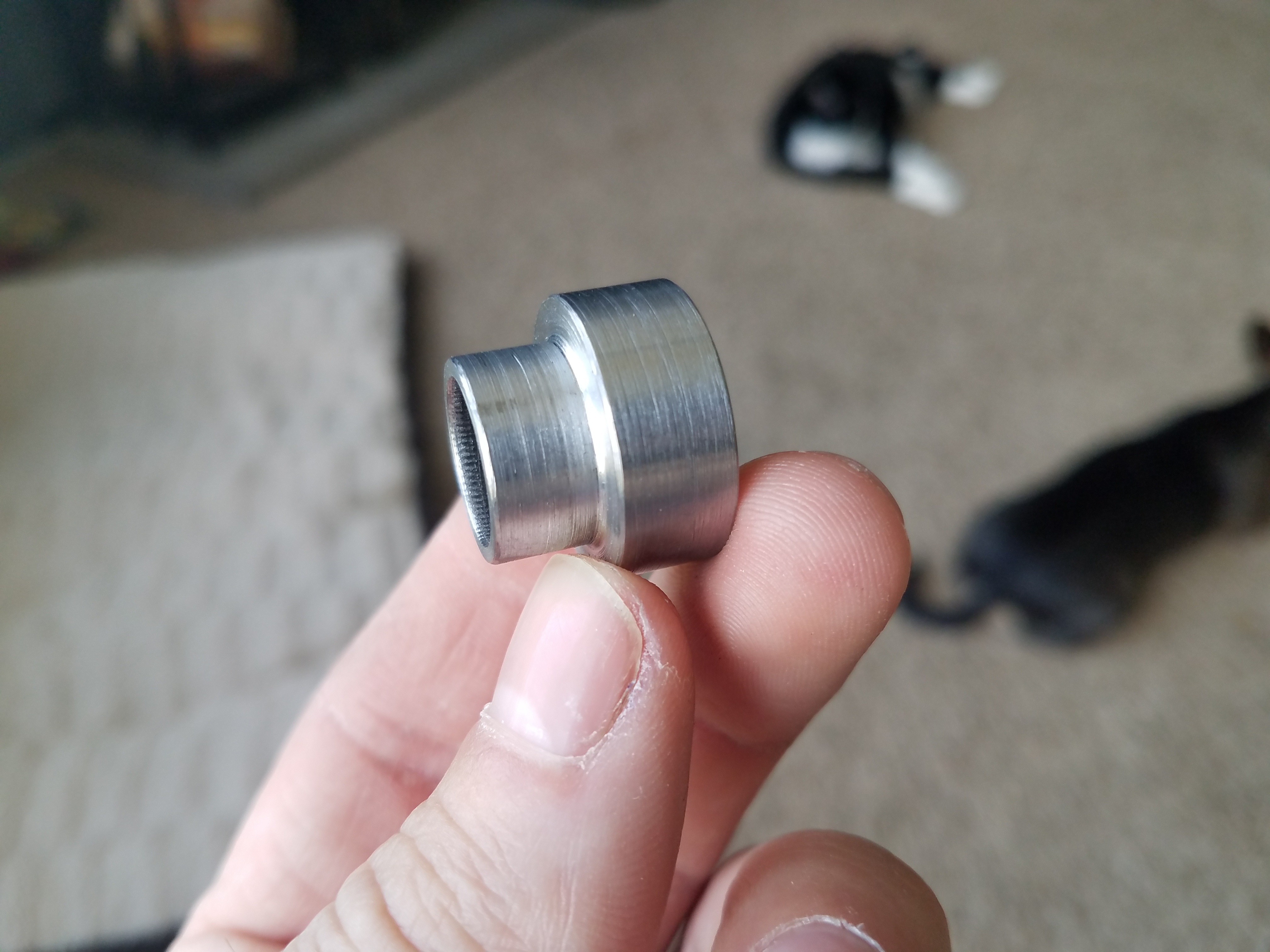

The only thing that I can think of is that even with the washers in there to fill the gap. There was still enough of a difference in size that let some binding occur. Since I can't find a bushing setup to my exact size, other than having a company make them. I just going to use a heim and I'm going to mill spacers so that the tolerances are almost perfect.

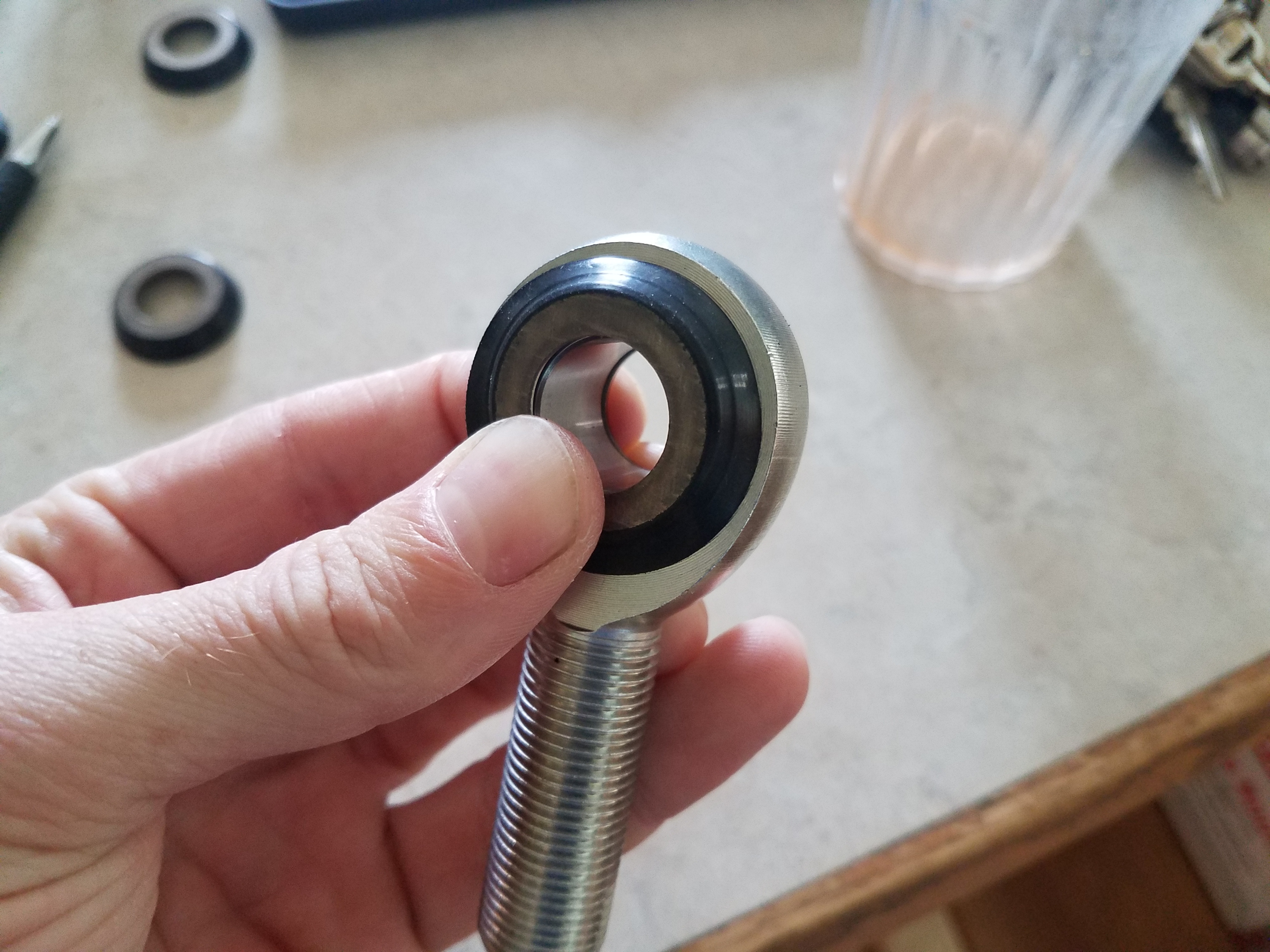

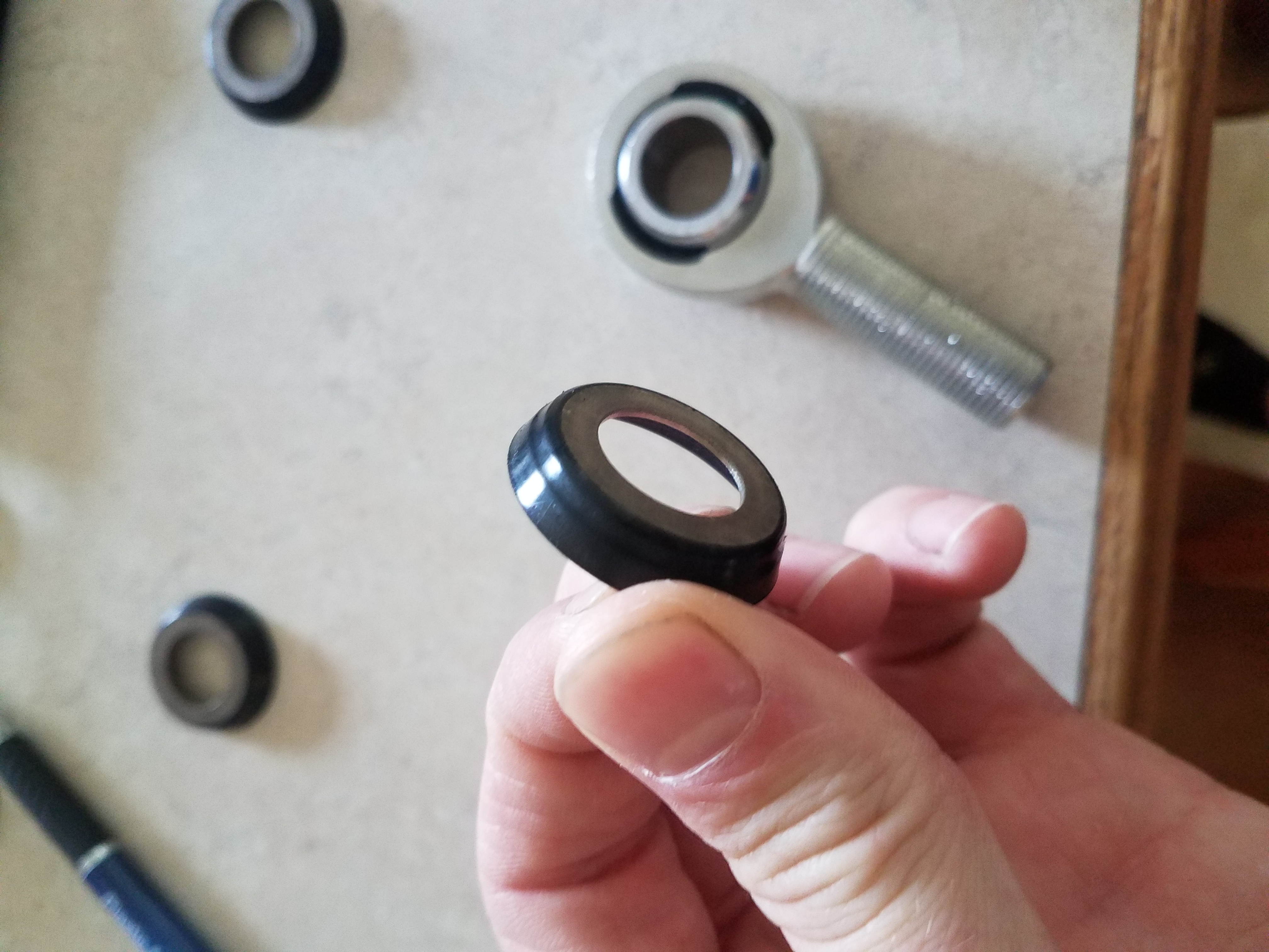

Well got the heim joints and the covers in today, just have to get the steel over to my buddy so he can get them all made. The covers are Interesting, I've never seen them before so I hope they work.

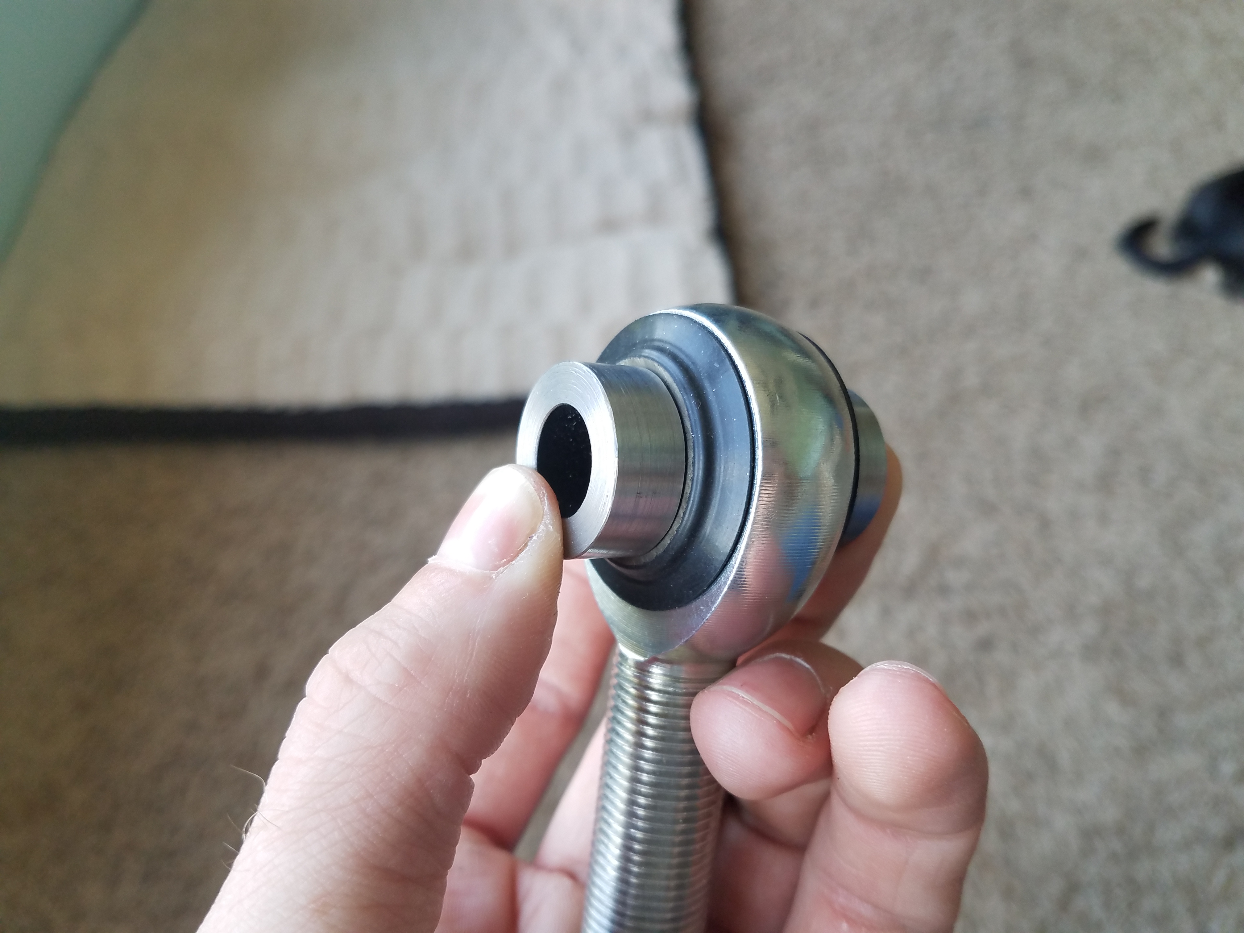

Well my buddy wasn't able to mill the spacers for me, he was out of town. So I had my local machine shop do it. They only charged me $30 and they turned out great. Just have to install and test this setup. Hoping for good results this time!

Yeah, I wanted to go towards a poly setup because I was always afraid of the heim being exposed to the elements, but after finding out speedway motors has covers I decided to give it a shot. I currently have $130 invested in this current setup. Just a fun little project and if it works I'll save some money.

91001504. Heim seals. Only 6 come in a pack so you would have to order two for each set of arms.
