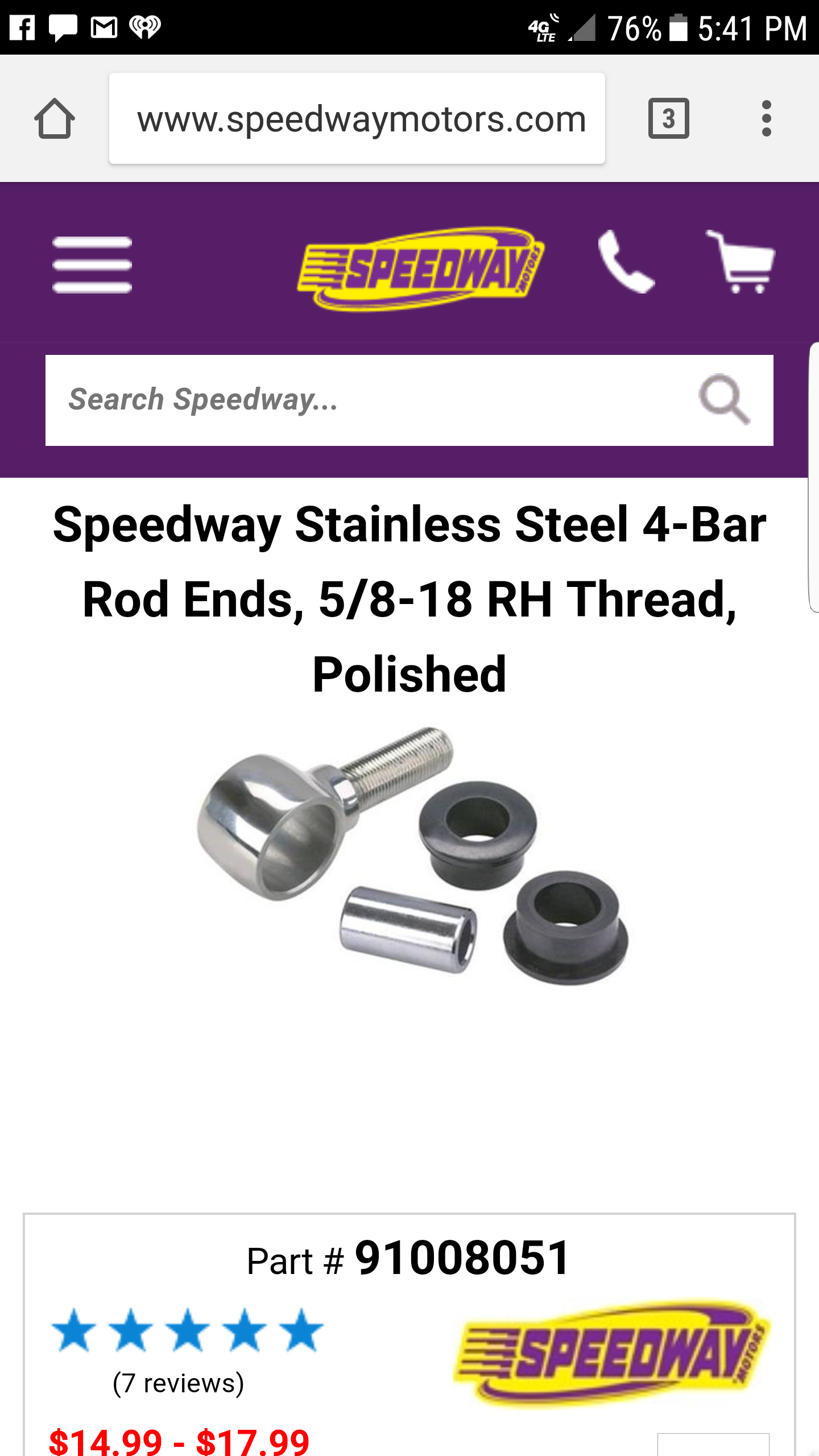

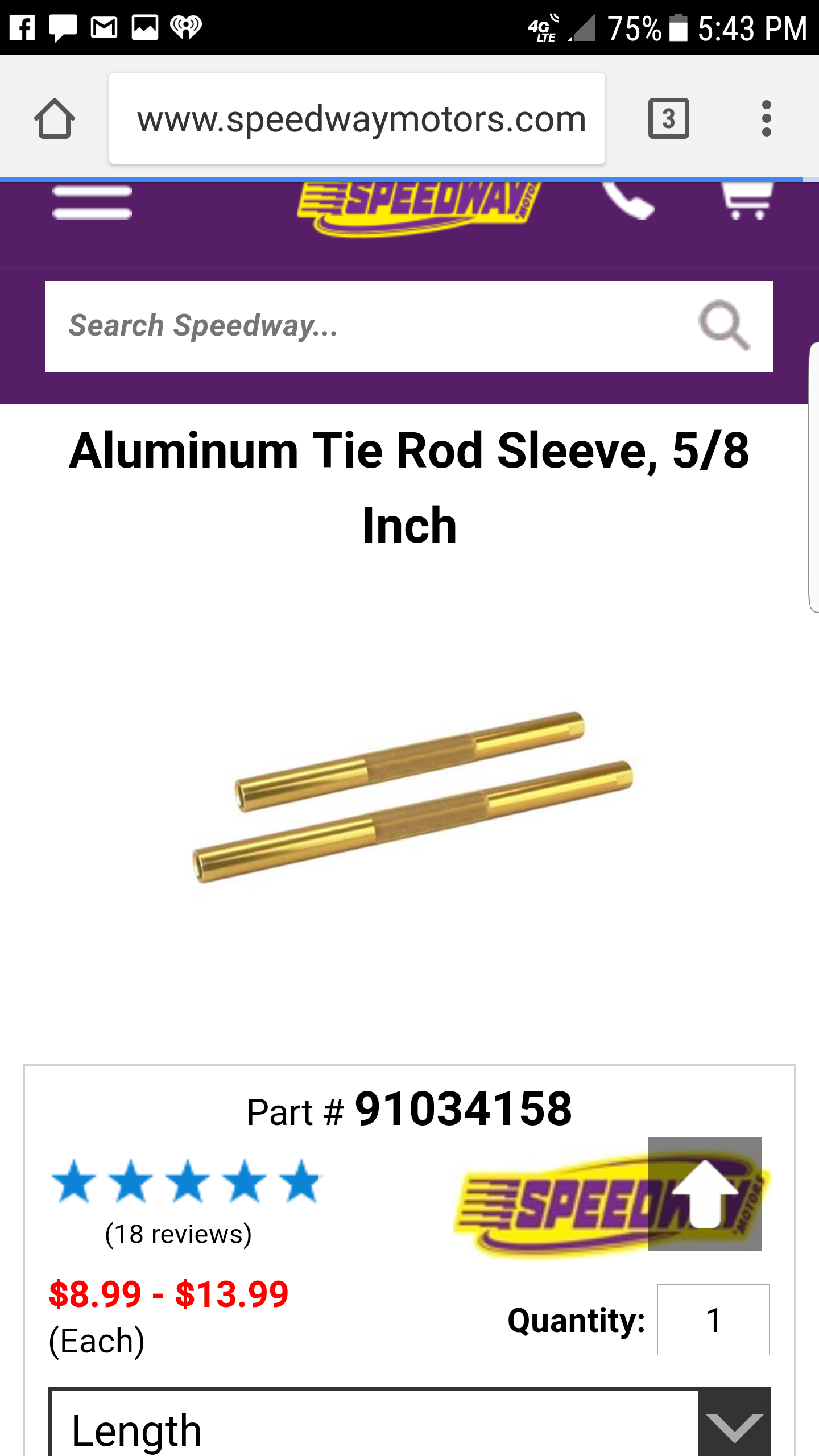

Diy rear camber arms!
Well Im going to have some fun and try and make a set of rear camber arms! The site has all the parts needed. Parts are either forged steel or stainless ends and aluminum center shafts. Just have to figure out what length shaft I should go with. Stock arms are like 21.5 inches from bolt to bolt. I want to be able to get a little more negative camber to fit my wheels right so I'm not sure what length shaft to get, any thoughts?

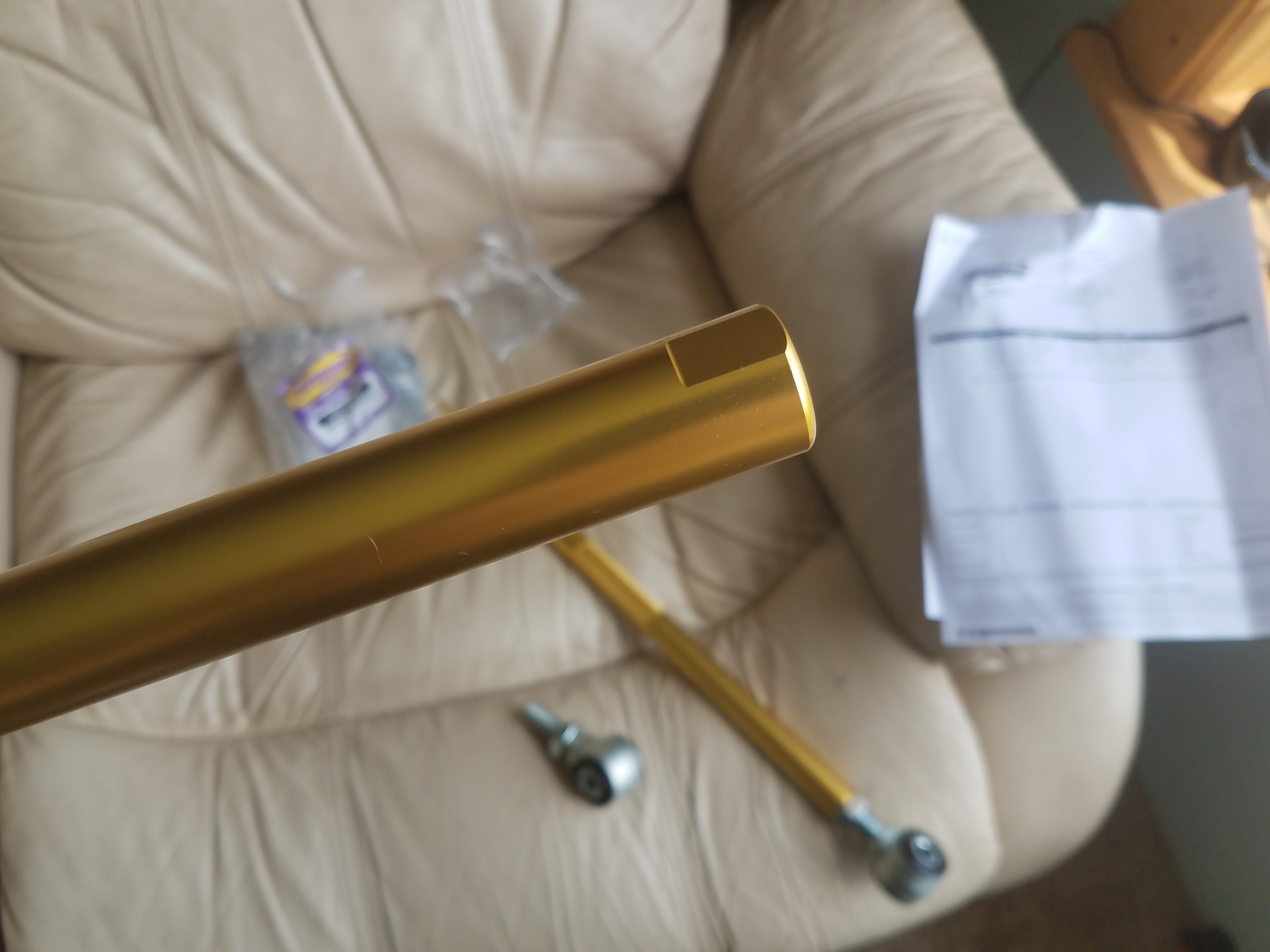

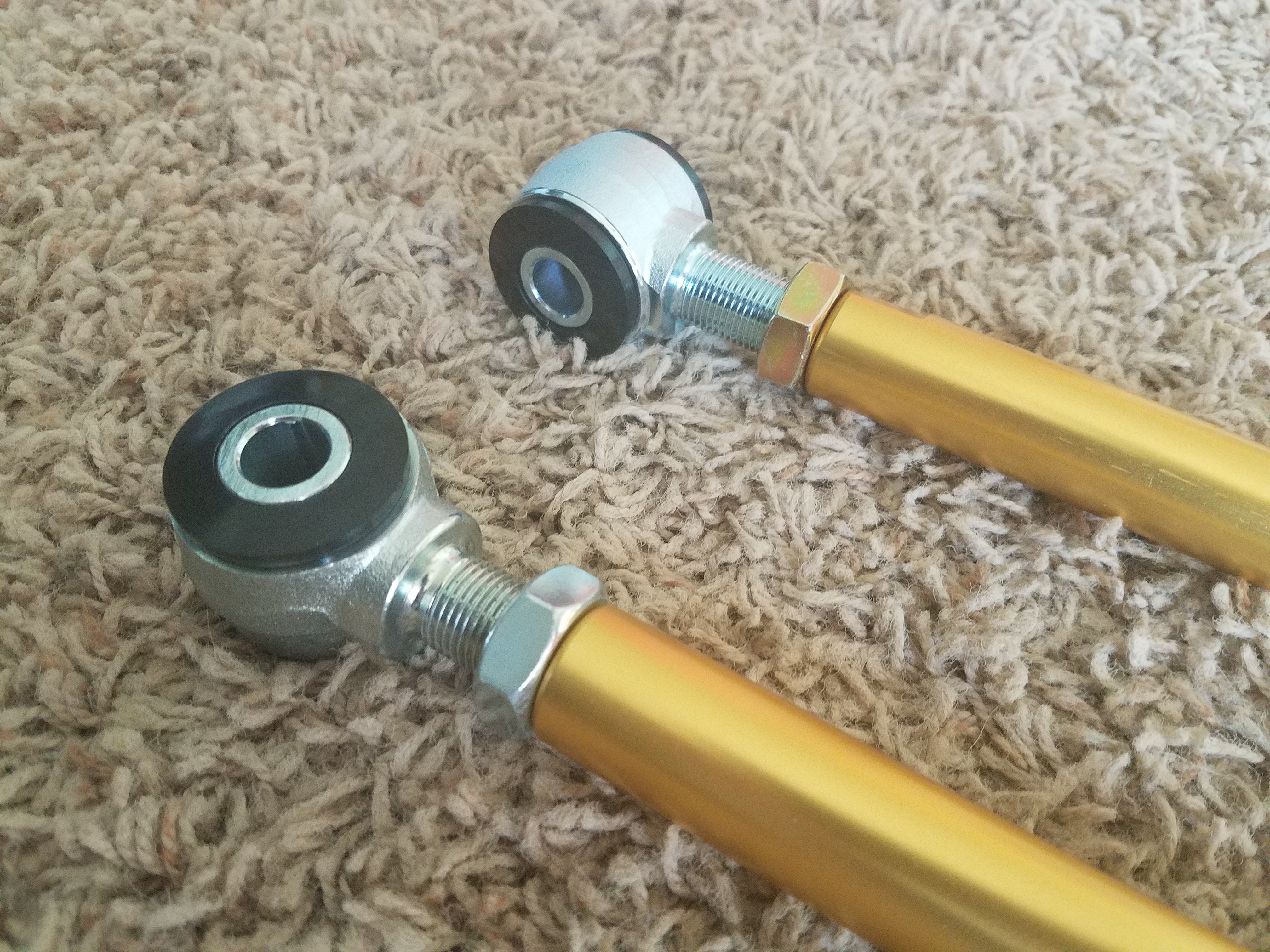

Well got the parts today and very first impression is, great! Everything seems to be solid and nothing stands out to be an issue. I went with a 17 inch center shaft. With the ends threaded Into the center shaft and measured out to the same length as the stock ones, There is 3/4 of an inch threaded Into the center shaft. I feel that is more than enough to be "safe" if you want more, then go with the 18 inch bar. But once you start getting more positive camber more will be threaded in. Overall first impression is a good one! Just have to install them and get an alignment and just drive on them and see how they last. But for 83 bucks in materials I'm willing to give it a shot. Also I went with forged steel ends that are zinc plated. You can go with polished stainless ends if you want it to look better. But since it's under the car I did not care.
Attached Thumbnails Diy rear camber arms!-20170428_122814.jpg   Diy rear camber arms!-20170428_122832.jpg   Diy rear camber arms!-20170428_123143.jpg   Diy rear camber arms!-20170428_123148.jpg

How long are the threads on the rod ends? For a 3/4" bolt thread, you want AT LEAST 3/4" engagement into the rod. That should be your maximum arm length. That being said, if your maximum arm length is slightly longer than the stock arm, should be golden. If you lower the car, rear suspension goes negative anyway, and you'll be shortening the bar to dial it back in.

The threaded end of the end links are 1 7/8 of and inch. From the end to the center of the hole is 2 7/8 of an inch. I have 3/4 of an inch threaded in and that makes the bar the same lengh as the stock arm, so once I start getting more positive camber, bam, it'll be threaded in even more! I think this will work out just fine!

one downside is that they come with nylon bushings. Not sure how long or well they would last. But they can be swapped out with poly.
