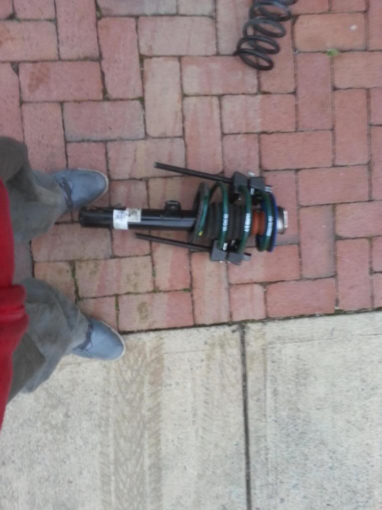

heres the car jacked up and the struts/springs taken off

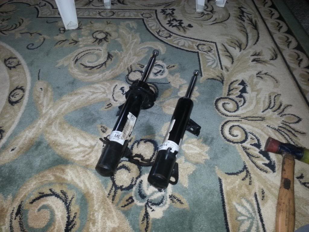

here are the front struts the ones you really have to change. you need to hammer off the perches. when i mean hammer i mean lightly hit them off haha
here are the rear struts big difference and yes my old ones are really bad i pressed them down both at the same time and needless to say my old ones took about 1 day to come fully back up >.>

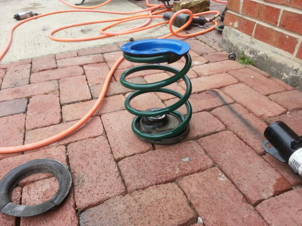

remember that you need the old perches from the r53 strut on the r56 strut heres what it looks like without the r56 strut
and heres what it looks like compressed and screwed on. i ended up getting hotchkiss adj. camber plates and i love them. but the fronts are a little higher because of this. i will be uploading pics of this later. ALSO REMEMBER to copy how the old perch is facing on the old strut. i made this mistake and had to take it out compress and move the perch around. a real pain.

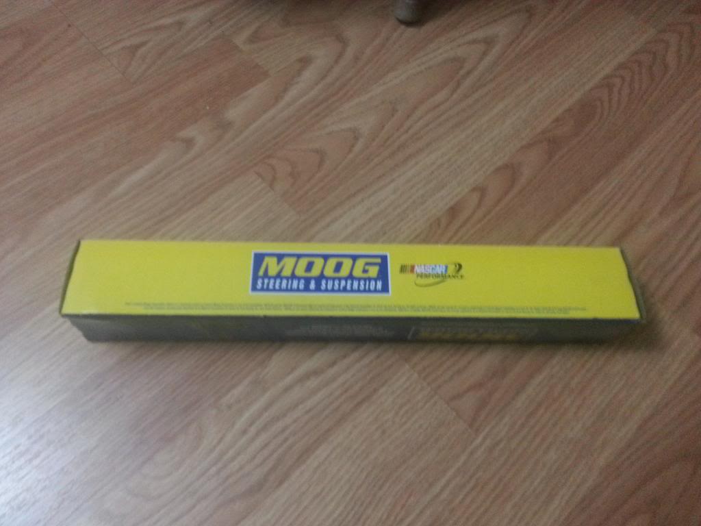

moog sway bar links
so i ended up changing my sway bar links and wanted to change my bushings as well but you have to drop the whole sub frame so im saving that for another time
Here are the new moog sway bar links in box

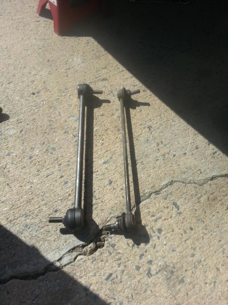

here they are next to the old ones to see the difference. you can order them from any advanced auto parts store they are 35 i believe each. great upgrade if you dont want to go with the adjustables
