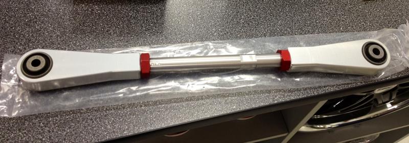

Sorry 1 Day late and getting them installed right now.. From the looks of things, it seems to going to fit perfectly for me. My car is blowing through the dampening of the rear shocks too quickly and by installing these and getting back to maybe a .5-.9 neg cam vs
-2.9 or more will solve the problem. One thing I can say, it seemed to raise the rear as it is on the racks getting aligned.
Here is the pic of the specialties products arms. Only reason why I picked them is:
1. Billet alum = light
2. easy adjustable
3. urethane bushings = quiet
4. +/- 4 degrees of adjustability
Ill give you more updates in about an hour, but I can say this is a must if you install any lowering kit more than .75" There is just too much going on to not justify it.
Well depending on your 19" wheel application
LiveStrong and Hujan, Alta's are nice, but didn't have them in stock and H-sport looks good, but no one can confirm if the R60 can use previous models.. This was the only 100% guaranty I could find.
