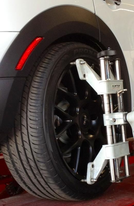

Hsports are now installed and everything's back in alignment.
They gave me a before/after alignment report, wish I had received one after the previous alignment (so I knew how bad stock was with the lowering springs).
Old Jul 12, 2012 | 03:03 PM
  #50
MotoGreg's Avatar
MotoGreg
Joined: Jul 2007
Posts: 242
From: Orange County, CA
WTF? How in the world is negative three degrees the correct spec for the rear camber? That printout is from a Hunter machine, I'm thinking that Hunter may have input the wrong parameters for the R60 in their software. I can't imagine that the spec from MINI is any more negative than about one degree.
