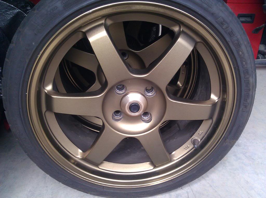

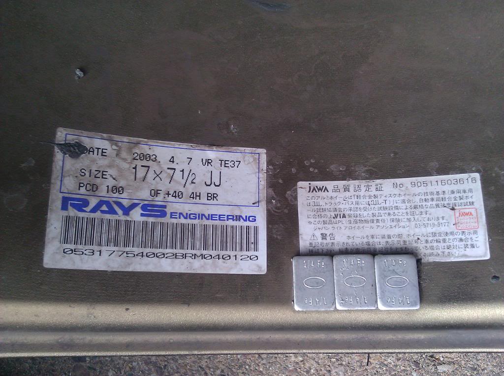

the wheels are forged Rays 7.5" not sure of the offset.
Attached Thumbnails OHLINS installed on the R56 !!-rays-wheels-img_20111001_132839.jpg   OHLINS installed on the R56 !!-rays-wheels-2.jpg

Very sharp looking wheels
The tag says "OF +40"...seem that might be the offset?
yes I believe so

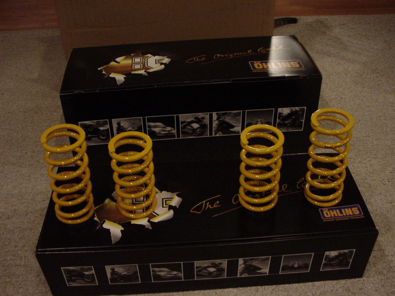

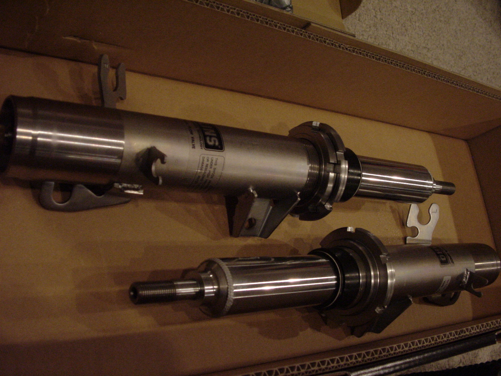

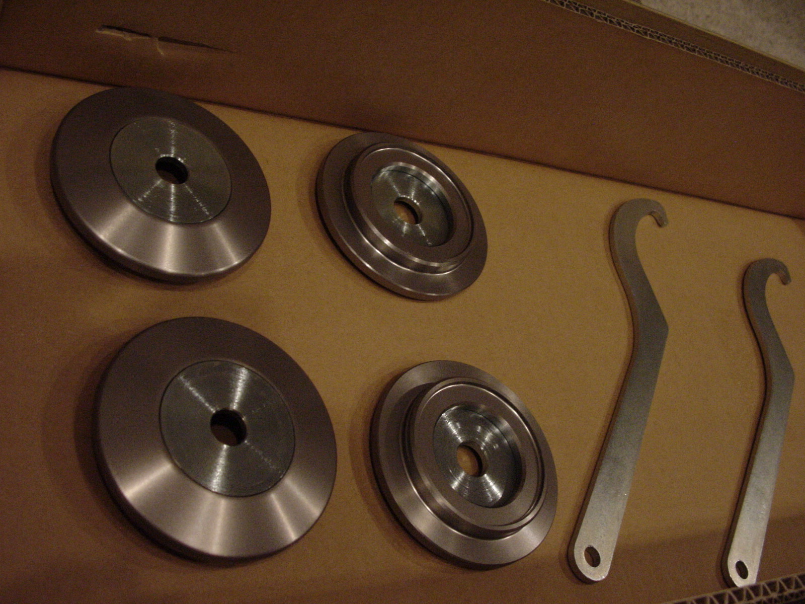

got mine yesterday!
Attached Thumbnails OHLINS installed on the R56 !!-dsc04545.jpg   OHLINS installed on the R56 !!-dsc04567.jpg   OHLINS installed on the R56 !!-dsc04557.jpg   OHLINS installed on the R56 !!-dsc04548.jpg   OHLINS installed on the R56 !!-dsc04561.jpg
