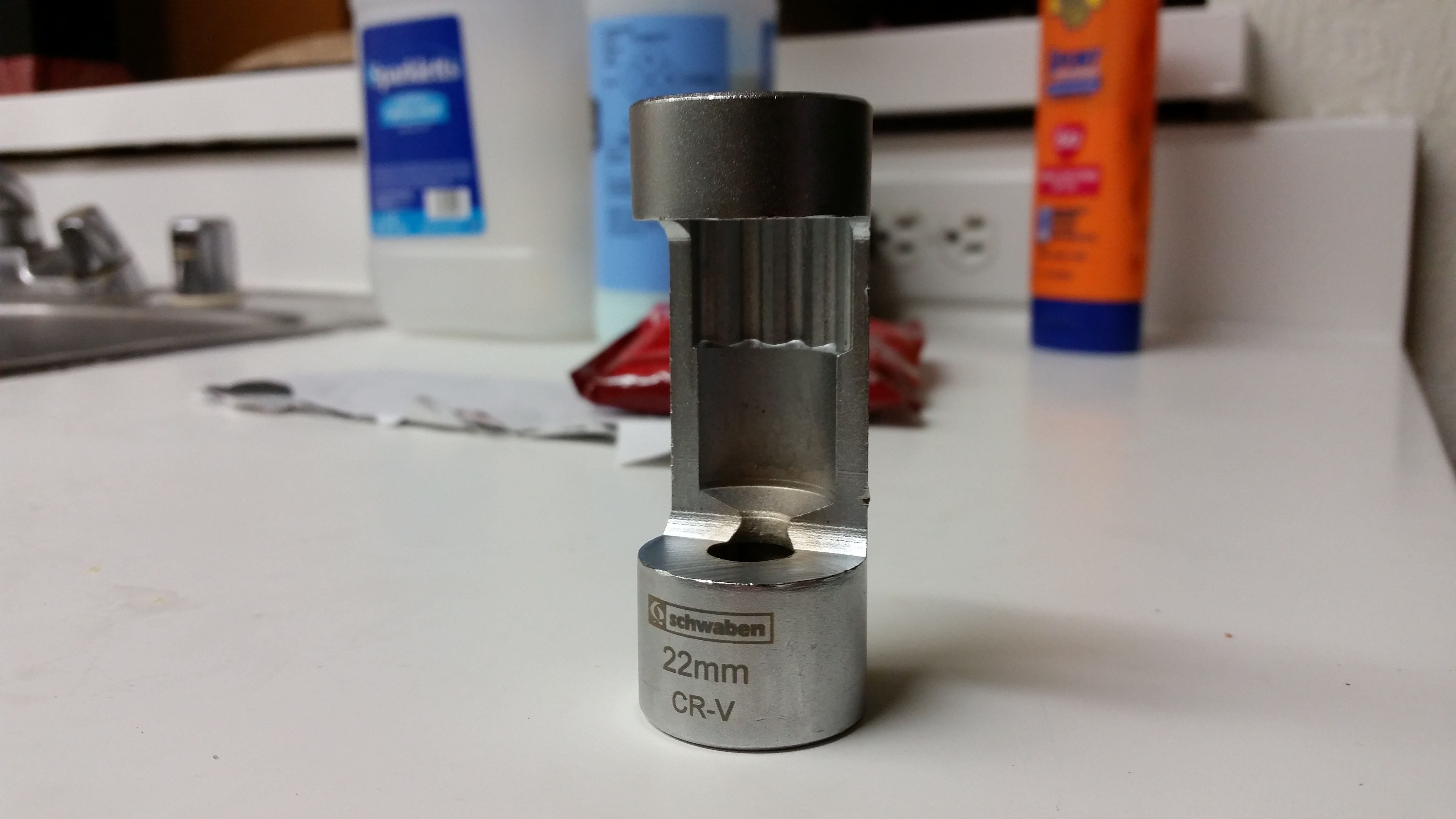

Pictured below is a 22mm strut nut socket for a 2007 Mini Cooper S, you can always remove the plastic/rubber cap to access your strut nut to determine your size strut nut, you don't need one for the rear shocks. ESC Tuning sells all size strut nut sockets. It extremely important that you not allow your shock shafts to spin when you're torquing down the front strut nut! Just follow the instruction to the letter and everything will be fine, take your time with them, no rush. Rushing usually ends in tragedy, savor and enjoy installing the Ohlins.

Good advice,
The socket is right here:
http://www.ecstuning.com/Search/SiteSearch/ES2652183/
