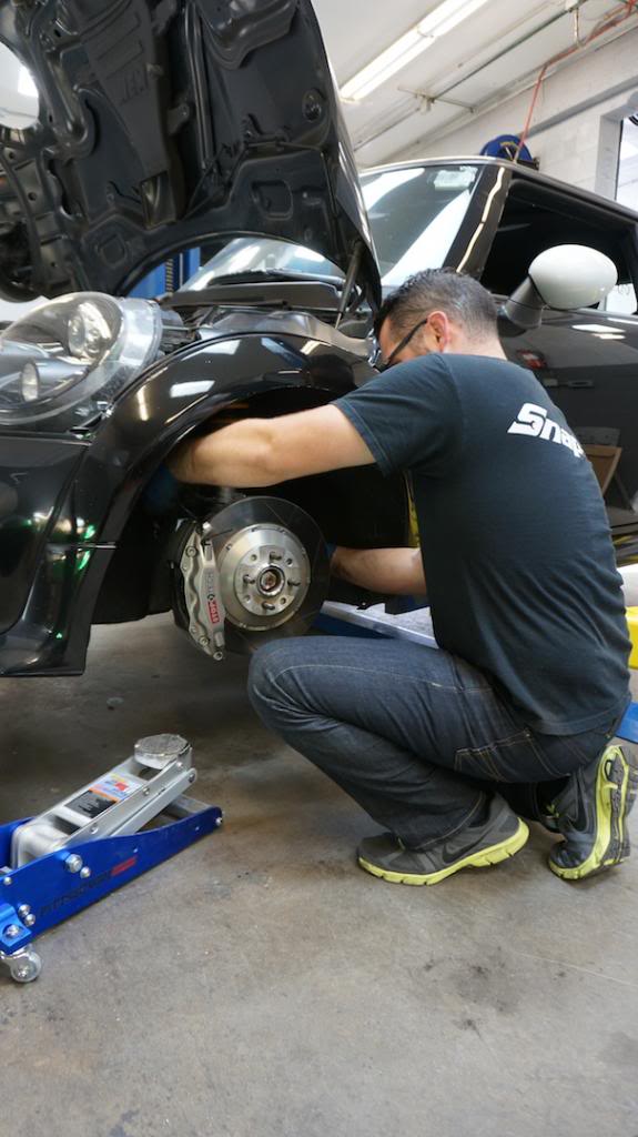

Yeah this guy :D
Ivan Madrigal @ Strasse Sport in Covina. Swapped out my Ohlin coilover springs to Hyperco springs in less than a hour :D

Great Brake!

^Thanks! They stop great too! :D
