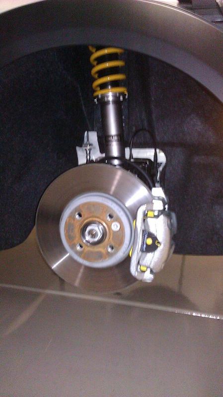

Recently installed the Ohlins DFV Road and Track coilovers (BMS MI20): http://www.roadandtrackbyohlins.com/...ts/bms-mi20-4/
These are really, really, really good.
I installed them with the springs that came with the set up: F400/R285, 2.5 ID, linear rates.
Added Vorshlag camber plates and a 25.5 mm Hotchkis hollow rear sway.
Running Enkei Racing PF01 17x7 et38 with 215/45/17 Hankook R-S3
Lowered the car about 1 inch, and after some testing, set the rear bar to the middle position to help with the softer rear springs.
Here is the beauty of this set up: the adjustablility and great Ohlins valving. At full stiff (1st position on adjuster front and rear) with the rear sway bar in the middle position and 2.75 of negative camber up front, the car is race car stiff, grips like crazy, and rotates well. Adjust to 15 clicks from full stiff and it is a street car dream, and still tons of grip.
I will have it at the track in February, so it should be fun to dial it in, and confirm my initial impressions. I have driven many Koni set ups, TC Kline DA, Ledas, Bilsteins and various lowering spring combos, but these Ohlins are my absolute favorite, they are so versatile and well valved.
The ideal for track would be a stiffer spring in the rear allowing less rear bar, but the street comfort is so good with 285 spring when the shocks are dialed down. This spring combo is not as much a detriment as one would think because of the fantastic shock control and adjustability. Plus, at anytime, one can put a set of 400 lb springs on the rear with ease if wanted.

More photos:
Attached Thumbnails OHLINS installed on the R56 !!-imag0180.jpg   OHLINS installed on the R56 !!-imag0182.jpg   OHLINS installed on the R56 !!-imag0184.jpg

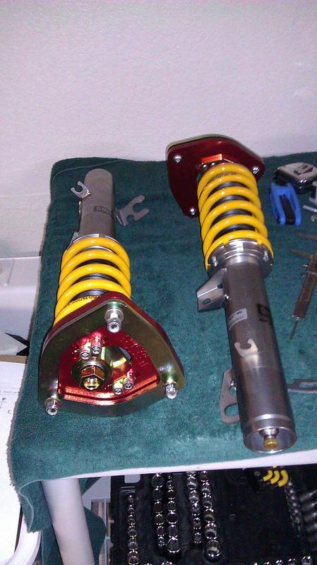

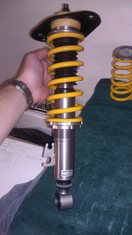

Here are some more:
Attached Thumbnails OHLINS installed on the R56 !!-imag0172.jpg   OHLINS installed on the R56 !!-imag0150.jpg

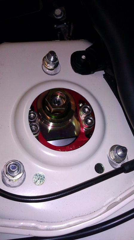

I built those camber plates. When the order form specified Ohlins strut tops (the spool pieces have to be matched to the strut top) it made me smile. I knew someone was going to have a good time with it.
Old Jan 28, 2012 | 08:58 AM

I have been smiling ever since I got them attached to the Ohlins too. Thanks Jason! They of course work and fit PERFECTLY with the Ohlins.
