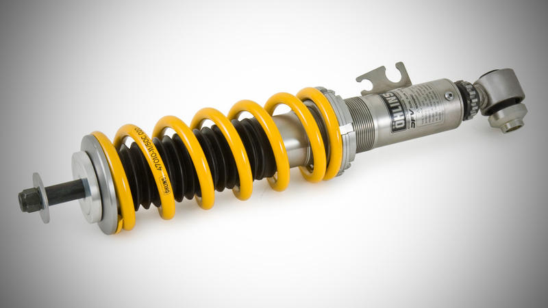

My Ohlins Road & Track coilovers arrives tomorrow and I got myself in a pickle. Today I purchased a Craftsman 20-PC Go-Thru Ratchet set and it seems the 13/16th fits tightly around the strut nut, that's great for dis-assembly of the OEM struts. I'm going to need a strut nut sockets for the Ohlins 12mm (Rear) & 14mm (Front) according the Ohlins PDF. Does anyone know where I can buy strut nut sockets locally?
Sears didn't have strut nut sockets.
Appreciate any assistance!

I have these ones
http://www.ecstuning.com/News/Schwab...22mm_24mm_Kit/
However, these only go down to 18mm. Most of the nuts are large, usually 21 or 22mm. The sizes you quote seem really small.

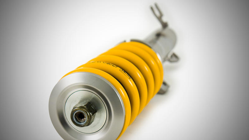

I have confirmed that the Ohlins are indeed M12 top nut for rear shock and M14 for front strut, so I need to find M12 & M14 strut top nut sockets. I have no clue where to find them? Those M21-M22 at ESC Tuning are useless to me if for some reason I was to re-install the stock struts and shocks which I don't see happening.
Also in the instructions I'm supposed to tighten the top nylon nut to 40Nm or 29.5ft/lbs.
Look at how small, almost the same diameter as the shaft it goes onto.

Not to be harsh or anything, but if you don't have a set of metric sockets, and a torque wrench, why are you doing any work on the car?
When a bolt or nut is classified as a M12 or M14 or Mxxx That is the diameter of the threads, not the size of the wrench. So a M14 nut will likely need a 17 or 19mm or maybe bigger socket.
At a minimum, you need a set of wrenches and sockets from 8mm-19mm with a 21, 22, and a 27 for good measure. (27 is for the oil filter cap) Plus extensions, swivels, adapters..
I've got tools in 1/4" drive, 3/8", and 1/2" drive in most of those sizes, along with impact sockets. And torque wrenches in 1/4, 3/8, and 1/2...
That's the one thing my wife of almost 30 years doesn't argue with me about, buying tools...lol

On my car, I was able to use an impact wrench and normal socket to take the stock struts apart, and a box wrench to reinstall. Which strut bearings/top hats are you using? You may get away with a box wrench and allen key to tighten by hand. 30 ft lb is not much at all, you can use your torque wrench on a similar fastener in a vice to get a feel for it, then just use the box wrench on your struts. Or you may get lucky and the shaft doesn't want to turn at that torque level?
According to a quick lookup, the standard nut for M12 is 18mm hex, M14 is 21mm.

I'm using the stock strut bearings and top hats.
I received my Ohlins coilovers and will post pictures later, the smaller of the two measures 17mm and the other 22mm. I can't locate any 17mm strut nut socket anywhere, so ECS Tuning only has half the parts I need.

22mm/7/8" is a common size for oxygen sensors, any auto parts store should have a cutout socket for that. I think that you can buy a 17mm deep impact socket and cut a slot in the side of it. Again, 30 ft lb is not much, you can model the slot off of the larger one that you buy. You may want to buy a 12 point socket, if you have a choice.

Basically with a box wrench and allen key and tighten as much as you can will get you to about 30 ft-lbs. The allen key will limit how much you can torque it, no matter what. If you really want to put a torque wrench on it, get the right size crows foot wrench for your 1/2" socket drive and use that, if your pass-thru sockets don't work. You will need put the crows foot on the wrench it so that the opening is 90 deg to the wrench so you don't over torque the nut. That will work on the rears. For the front there isn't much you can do except see if the pass-thru sockets will work. For the stock fronts I hold the allen wrench with a 8mm box wrench and tighten as much as I can. OK it is not perfect, but it is also has not come loose on me. No matter what, don't use an impact wrench to try to tighten the nut. There are plenty of posts about people doing that and shearing off the stem on the shock.

reverse your thinking - Sears has hex bits with a socket drive. I put an 8mm hex bit on my torque wrench (Brownline digiital) to hold the shaft and tightened the nut with a 17mm box end wrench until I got to the proper torque.

I talked with Jake at Ohlins in NC and he said to use my go-thru ratchet/sockets to tighten the strut nuts and to check the torque as I turn the nut every quarter turn. It doesn't seem as big a deal as I was thinking it would be, I purchased the 22mm strut nut socket from ECS Tuning and their shipping it Next Day Air and should have it tomorrow.
