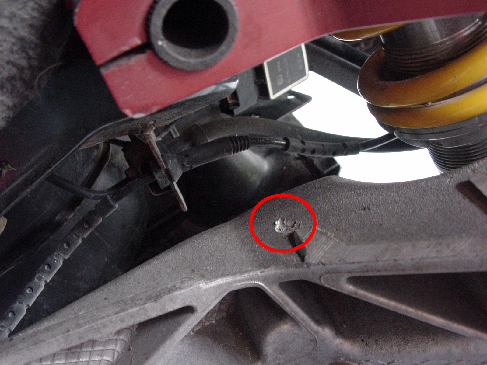

found the problem!
No more harsh bangs going over sharp pavement edges.
It wasn't the Ohlins it was the Tarett
(Or my upgrade to high strength stainless steel bolts that were too long and smashing into the trailing arm)
The sway bar arm screw end was hitting the trailing arm,
the suspension was effectively bottoming out on the screw end
Could explain why I went through two left side sway bar bushings in a couple of years on the drivers side only,I was pounding the snot out of them! The passenger side is not effected because the sway bar arm bolt goes through upside down on that side.
Attached Thumbnails OHLINS installed on the R56 !!-dsc05125.jpg   OHLINS installed on the R56 !!-dsc05128.jpg

LOL. It takes a brave person to admit they F'd up like that.

You had me wondering for a minute as I have the tarett too. Good catch !!!

Nice find. When I first read your post I was thinking that the the bolt was like an inch too long. Then I saw the picture and it looks to be only about 1/4" too long. That doesn't seem to be too long, but clearly it is.
So what was the fix - a shorter bolt or did you drill a hole in the control arm? Ok just kidding
Glad it's fixed

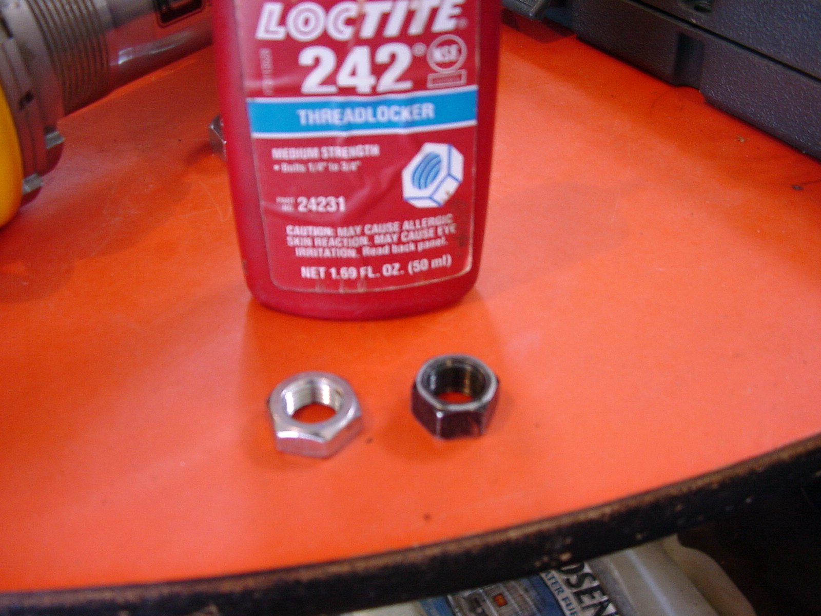

One more thing, the driver side rear Ohlins upper stud lock nut became loose and started knocking pretty bad. I thought during the first installation the mechanic forgot to torque it. However after I removed the shock and torqued the nut , it became loose again. So the second time I used locktite and it seems to be holding. If I do it again I would use double nuts.

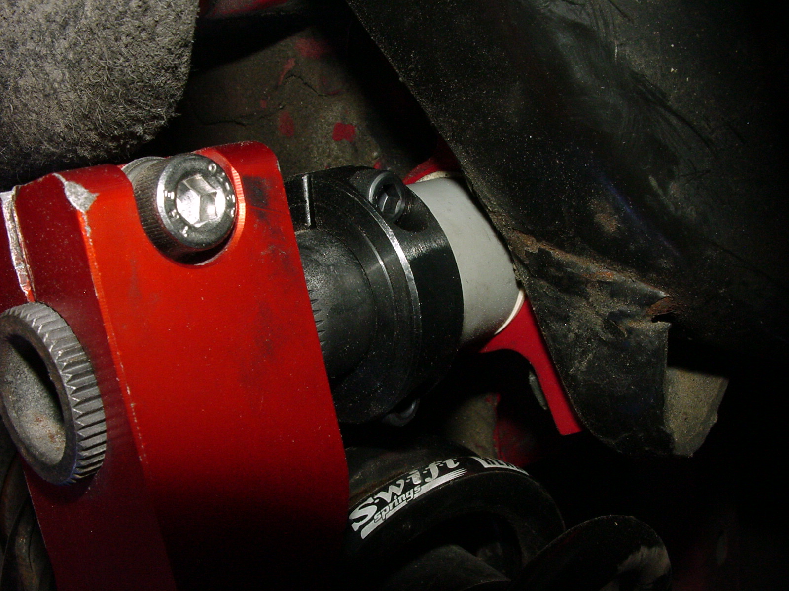

I should probably start another thread on the Tarett bar , however, I need to let you know about one more thing that can cause "knocks" The sway bar has lock collars( my aluminum ones broke, probably because the screw end banging) , Those collars are butted up against plastic spacers. I found the spacers too short causing the collars to hit the body and make noises, so I made longer ones. I contacted Tarett and they said they will start supplying longer ones. Heres some photos.
Attached Thumbnails OHLINS installed on the R56 !!-tarett-spacer-dsc03883.jpg   OHLINS installed on the R56 !!-tarett-spacer-dsc03885.jpg

Wow that is tight.
And nice ad for Swift Springs in your picture.

Wow that is tight.
Didn't notice that! (Got the swifts for sale , so far nobody wants them)

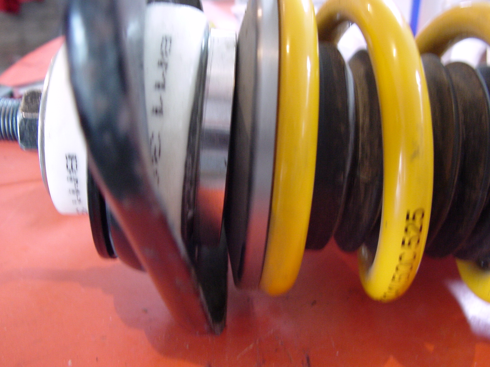

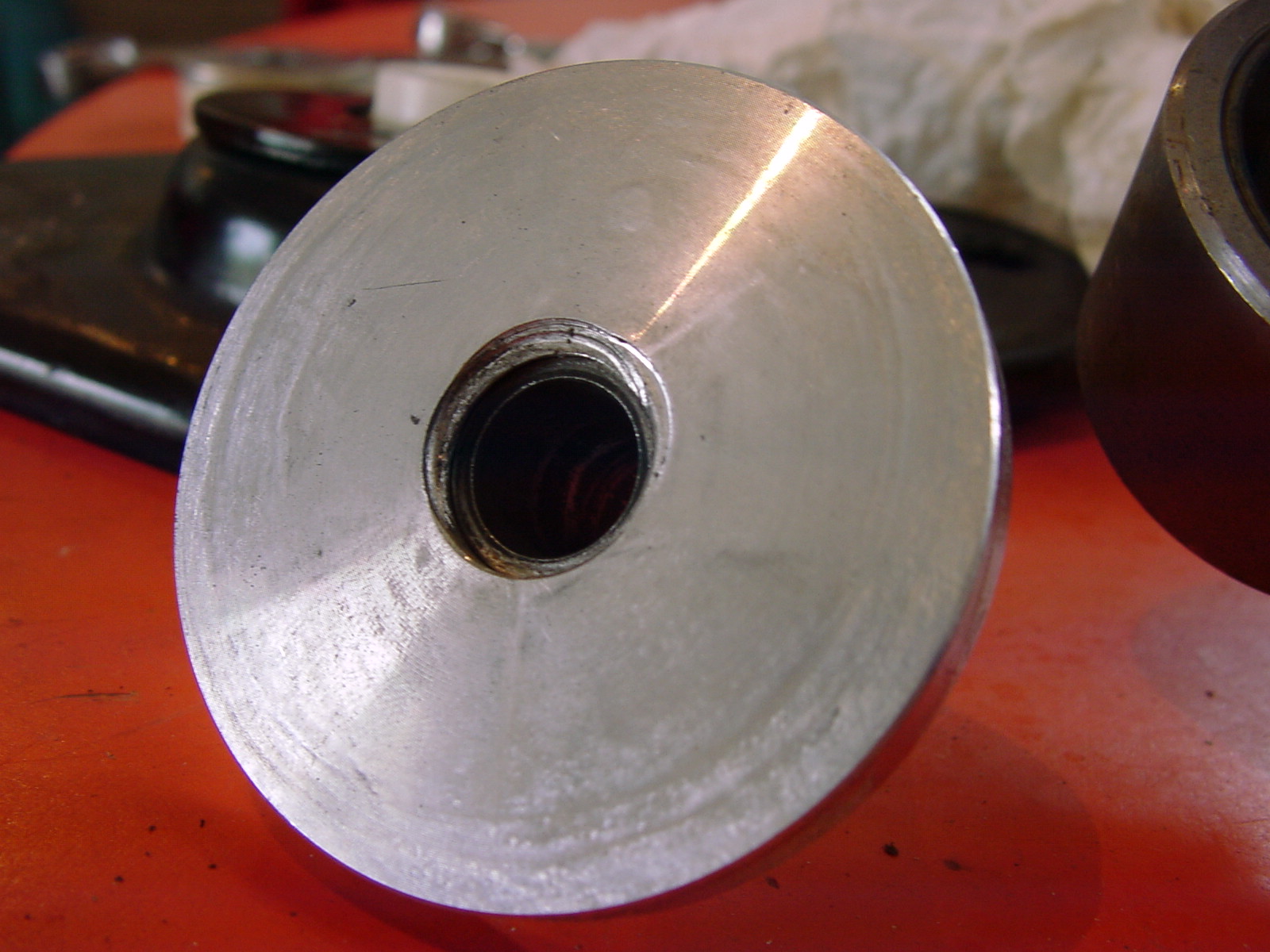

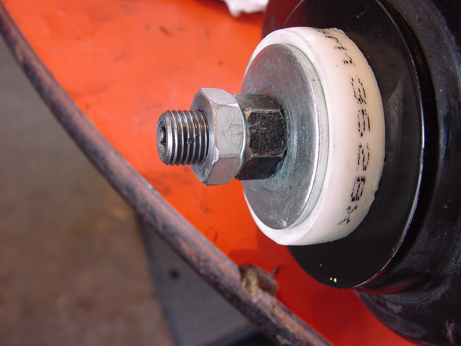

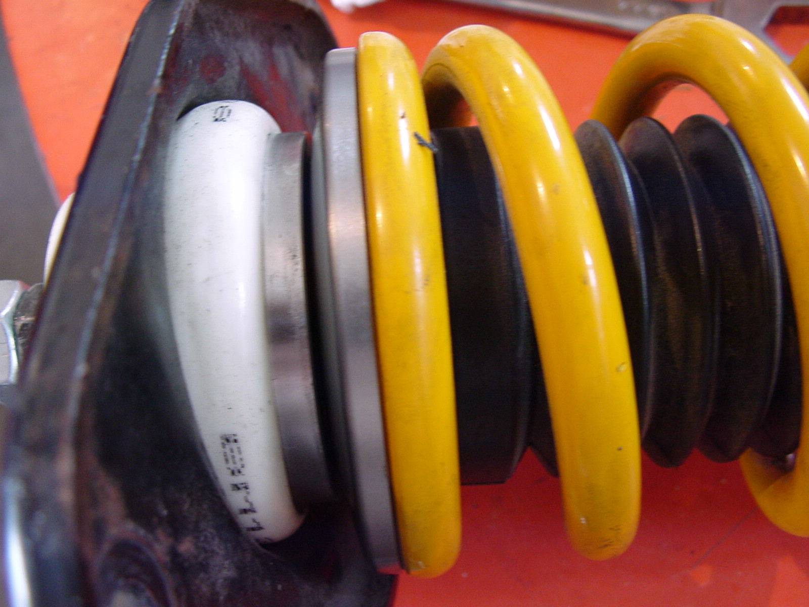

Found the Ohlins knock
Just proves that if you want to something done right you better do it yourself I found the tube spacer did not pass through the aluminum plate correctly , it got cocked , when the upper nut was tightened. After a while the tube spacer dug into the aluminum allowing the nut to relax, causing a slight knocking , I double nutted it all back together anyways.
Attached Thumbnails OHLINS installed on the R56 !!-dsc05174.jpg   OHLINS installed on the R56 !!-dsc05170.jpg   OHLINS installed on the R56 !!-dsc05177.jpg   OHLINS installed on the R56 !!-dsc05176.jpg

a couple more photos
Attached Thumbnails OHLINS installed on the R56 !!-dsc05173.jpg   OHLINS installed on the R56 !!-dsc05175.jpg
+1
I'm still correcting mistakes from work I had done last year, the latest of which was to fix a stripped lower rear shock bolt I had been driving around on all of this time.
