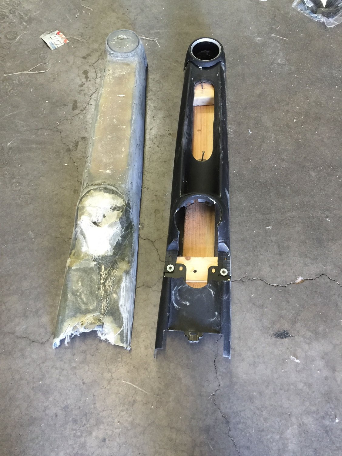

Next on my list is to start modifying my console to fit the CAE shifter. I was wondering what some of you have done to clean up the cutting required. I'm thinking about doing some fiberglassing to try and make it look like it was factory. I know bonding fiberglass and plastic hardly ever holds .
If I can get the complete console smooth I'm thinking about hydro dipping it in carbon fiber
Any pics or ideas are welcomed....

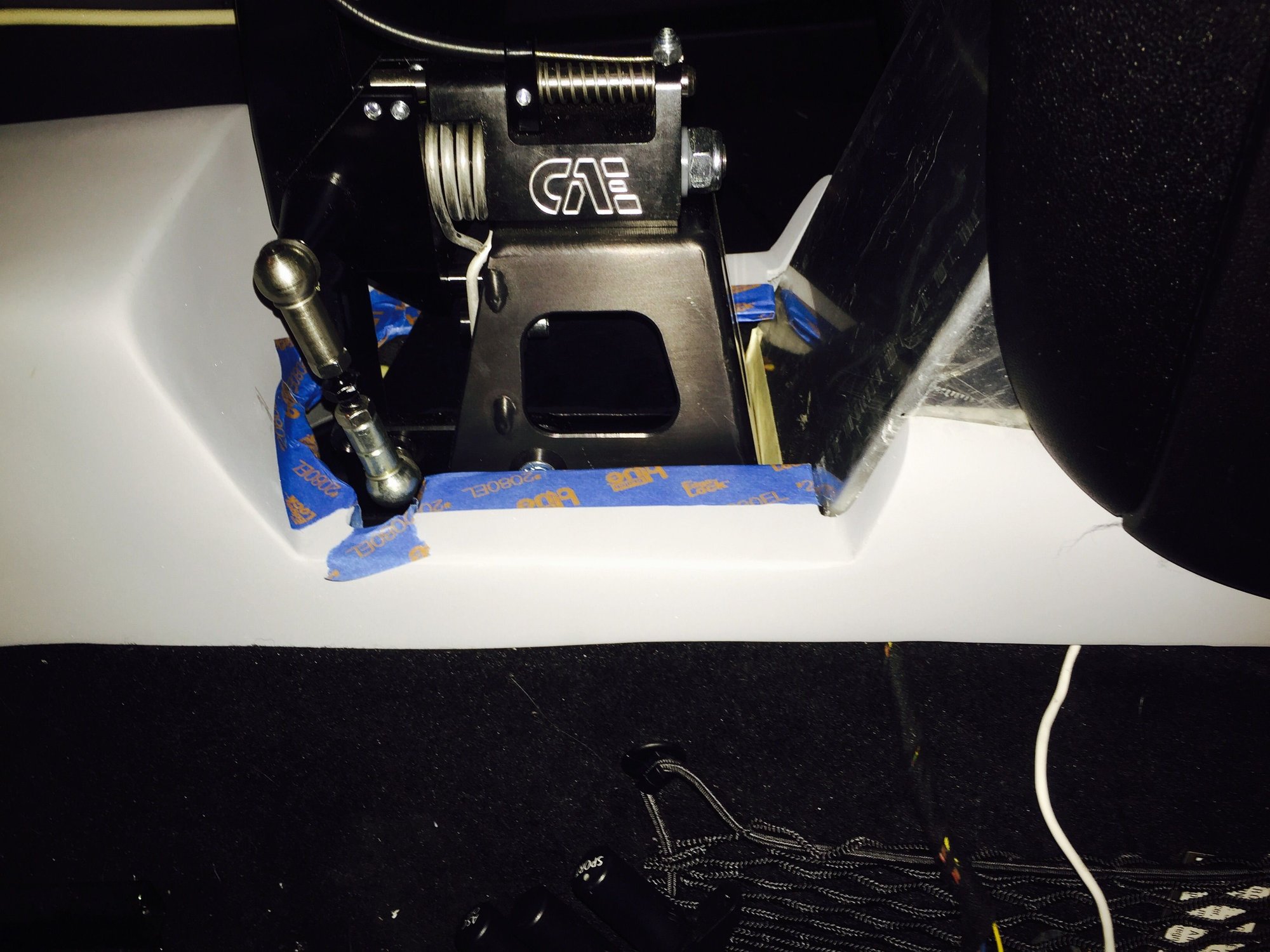

Well I wanted to get my console in and see if I wanted to add any more mods to it before the final finish was put on . Drink cup location is perfect now I'm think a slot for cell phone etc.
Need to install the Ebrake boot and the aluminum panel is getting a gauge, sport button/traction and a few other accessories buttons, cig lighter , USB , aux plug etc.

Some pics of how I got to this point
Waxed the hell out of the oem console and wrapped it in jersey material and soaked it with fiberglass resin.
Trimmed it up and got it in the car and started trying to figure out the angles. Beer boxes work great for forming
I moved the Ebrake up 1.5" and back 1.5". To aid in room for the cup holder. The end screws off and I can put a different tip in the ebrake that keeps the detent spring pressed and does not "lock" the ebrake up. Makes a cool cutter brake for kickn the azz around .
Poker table drink holders on Amazon 12 for 4. Brushed the lips in the lathe
