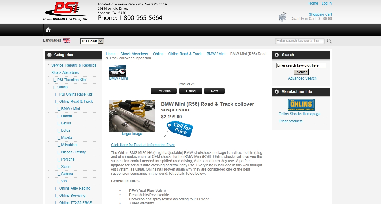

thinking I'm going for it!
sold a bike and have some cash to spend , so the Ohlins are a go
