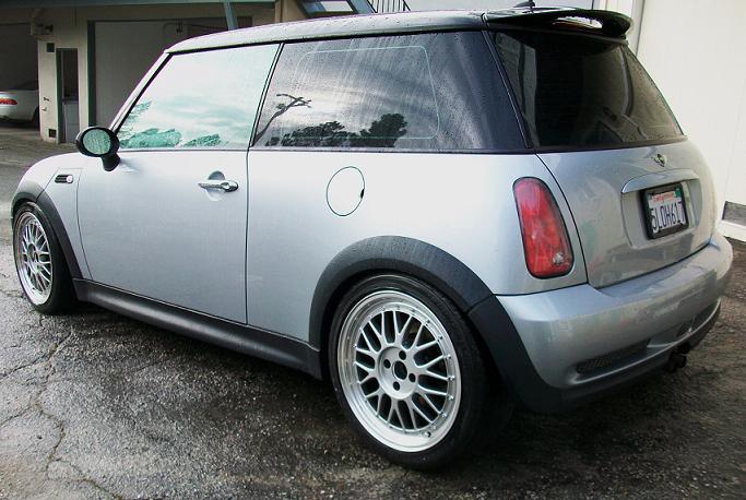

This is as low as I could get with the Megan coilovers, by the way. Looks like Fensty might be a little lower.

TylerF, I think I might grind that lip in the bottom of the sleeve out. So then our coilovers can go even lower, As long as you lock the spring tight you shouldnt have any problems I think.
