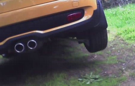

Minidrivr's Avatar
Minidrivr
Joined: Jul 2007
Posts: 2,881
The stock "sport" suspension does this as well.
